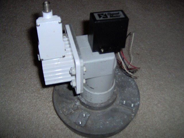

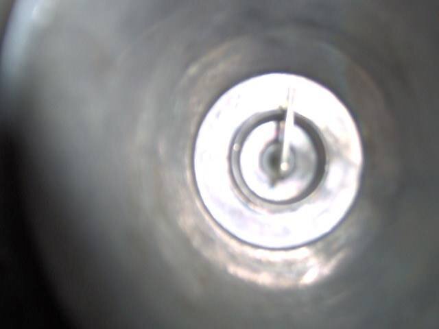

Here are a couple pictures to illustrate
1st is the inside of the LNB. Note the one notch for skew. LNBF's have another one at 90 degrees off that. That notch turns depending on the skew of a channel
2nd is the LNB. Note the 3 wires and the black box. The 3 wires get hooked to the receiver and the box sends a signal and that little black box turns the notch inside to the right skew
