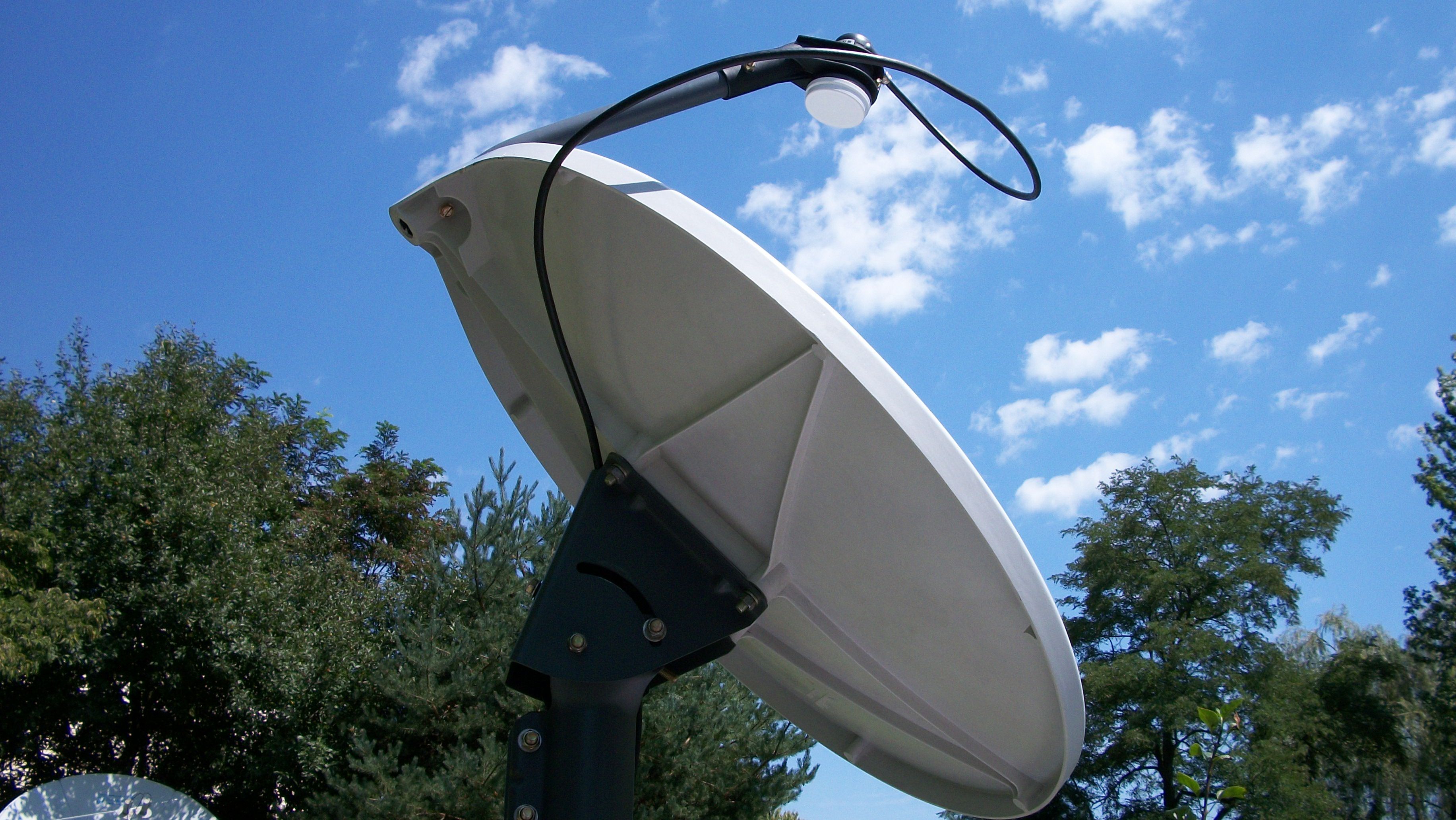

Thank you! Your comment is very much appreciated. Mainly I wanted to share descriptions and photos of what I did and if it worked. My original inspiration for the Dish 500 was from some photos that Fred555 graciously provided. The inspiration for my second setup came from this post http://www.satelliteguys.us/xen/posts/2602285/.
What's the size of the dish you used?
The Dish 500 is about 22" high by 20.5" wide. The Wild Blue is about 26" high by 28" wide.

Give it a try. I'm sure the 32" would much better than either of my two setups.
The only thing is being so far north i may have to put it up on a pole 20 feet over my roof. Trying to ponder how to do this.
As long as you have LOS you should be good with a 32inch dish. Many use a 30. And quite a few use slightly smaller. I am using a 30 inch Channel Master, inverted, as it's elevation is only 6.4°.

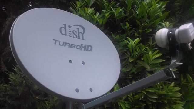

Here is my weekend DISH project.
A friend dropped of a Dish Turbo HD a few weeks ago. Up until now I have only experimented with DirecTV dishes.
First I removed the LNBF assembly:

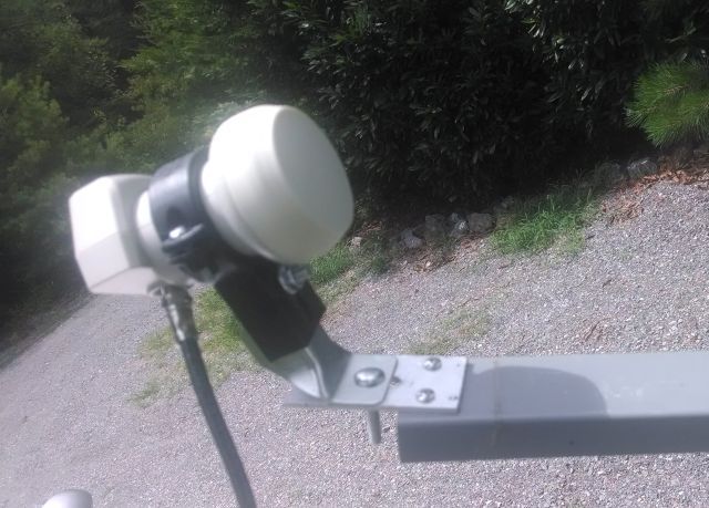

Then after a little trial and error I made an adapter plate out of 1/8 aluminum flat stock. No extra hardware is needed besides the plate and the lnbf holder. I reused the screws and nuts that came out of the assembly above. The existing screw holes in the arm were reused also. No drilling required in the arm.
Sitting out in the yard watching RTV until the sun came out. HOT!
Once the sun goes away I will tweak a little more. Currently at 55% Q with steady picture.

Its a Titanium PLL. I still have to tweak some more Q out of it tomorrow. It was getting hot today and was getting enough signal to watch in the shade and called it good enough for now.
My 30W dish is a DirecTV dish. I'm far enough east that I don't have to invert it.
I think I'm not even bottomed out on the elevation adjustment.
It's a Manhattan RS-1933 receiver and a Titanium PLL-Ku LNBF.
I searched Satelliteguys to find active transponder information. Active transponders were then manually input into the transponder list in the receiver.

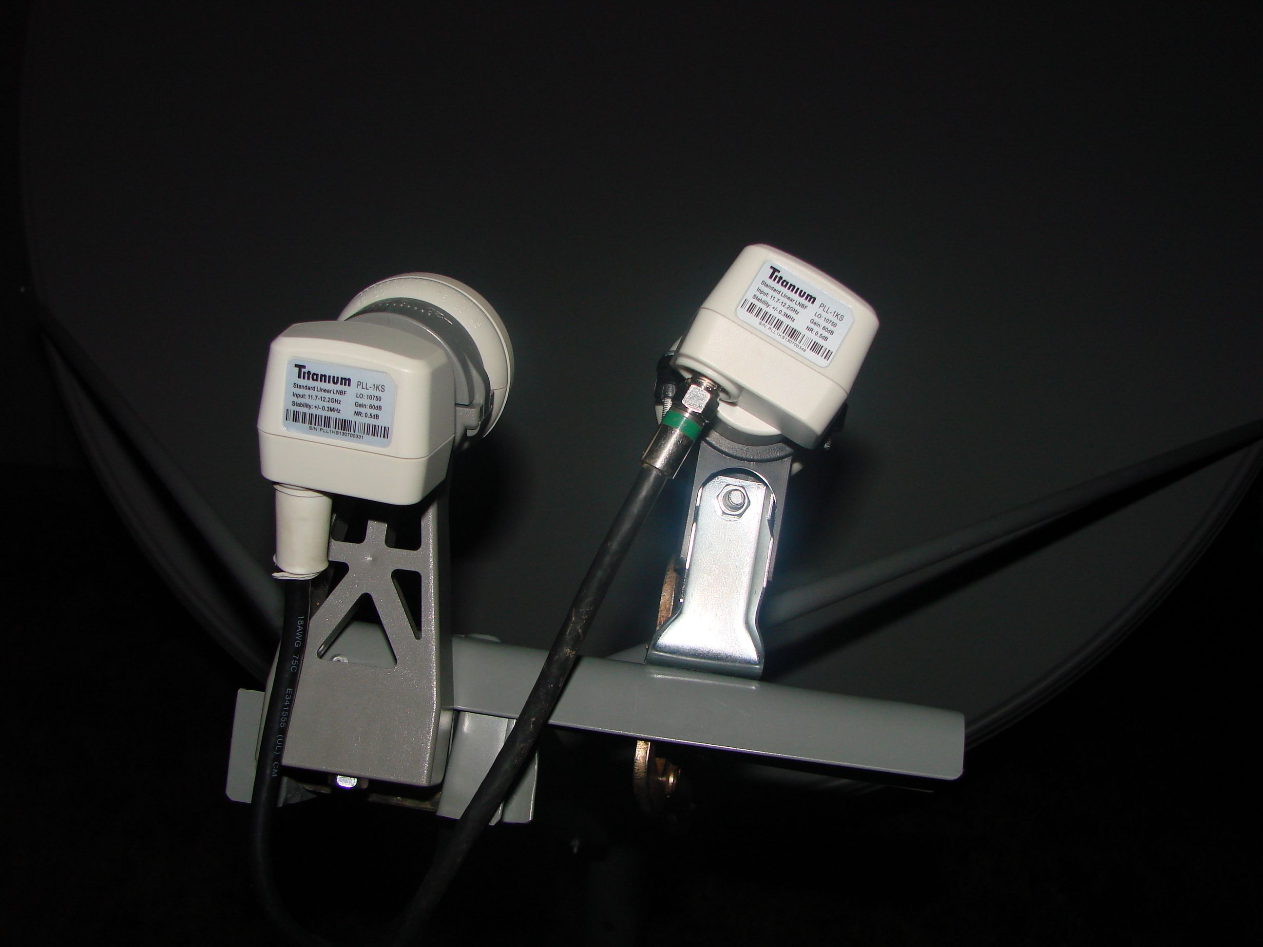

Hey Jason, where did you go to buy the Titanium Ku LNB?? I went to Titaniums online store and didn't see it there at all. If your picking up Cubavision that strongly on a small dish, I definitely need to swap out my LNB. I'm using an Invacom PLL Universal LNB which is supposed to be near top of the line, with my 90cm Geosatpro Dish; but I don't get any signal at all from that satellite. I even double checked my elevation settings to be sure. Could you post a pic of the label on the back of the LNB? Thanks! :-)
Reactions: Titanium
I bought them off KE4EST's ebay listing (linked in Titanium's post above). I've got 4 or 5 of these LNBFs now.
The PLL-KU was used on both my little dish setups and has performed very well. I'd would imagine that with a 90cm dish you'd have even better results.
About a month ago, I did a direct swap of a Titanium PLL-KU for an Invacom SNH-031 universal on a non-peaked 1.2m dish on 125W. The results were quite impressive. Photos of receiver Q showing before and after are here
Photo per request...
