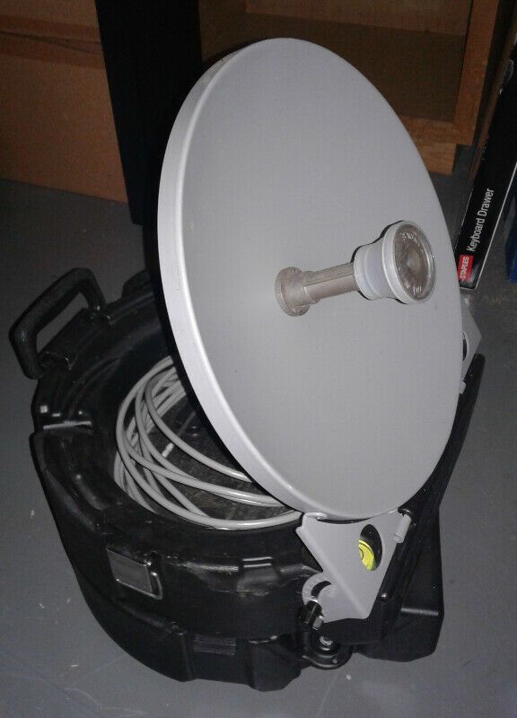

I've got a couple four footers in the yard but haven't seen anything smaller.
