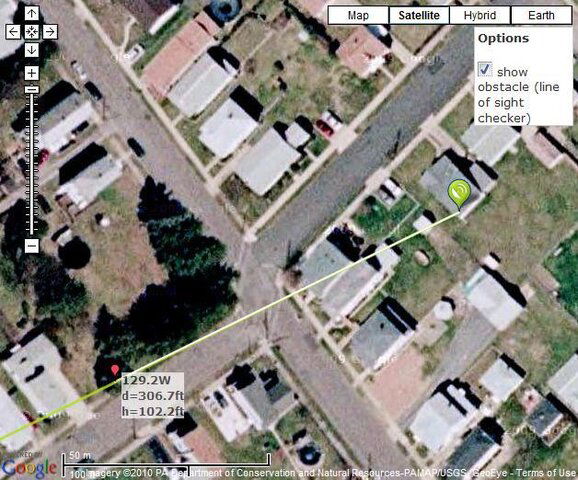

Northeastern PA is NY RSN's
129 is useless to us here.
With a look angle of 18 degrees don't count on tuning it.
You either need to Go 100% Eastern Arc, (1000.4) Meaning get your Equipment upgrade, or suffer with the Missing HD channels.
