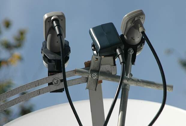

Yep already planning on that.just waiting for the rain to go away.is Amc 1 to far a distance apart to get that.I seen some KET channles there.since I live in KY.anyways thought why not if I can
AMC 1 is too far away (20 degrees away from G10R). The most I have tried for is 10 degrees off centre (AMC3 and IA5) and while I was able to get all transponders on AMC3 there were some that were very weak. I moved IA5 off centre by at least 2 degrees (and then re-pointed the dish at it) which moved the AMC3 LNB to about 8 degrees off centre. While there was minor signal loss off of IA5, there was a greater increase in signal strength on AMC3, and the weak transponders became fine for viewing. (See attached photo for current setup.)
Plus, the KET channels are Digicipher 2 so you wouldn't be able to get them.
