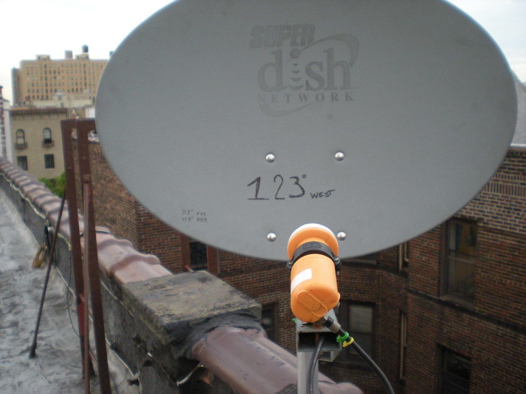

Very Easy!! I am Using that baby for 123West and get 75 quality on all channels
This superdish (36" oval) performs better then 75 inches round dish for fta
Works for me even on rainy days.Location NY City.

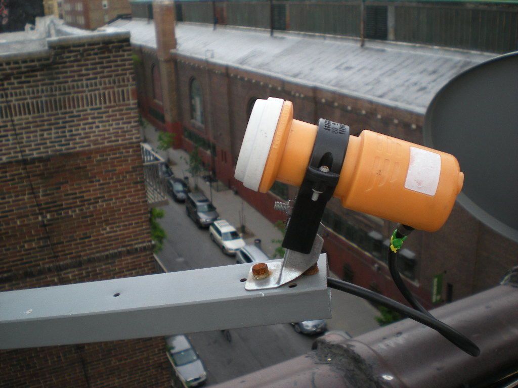

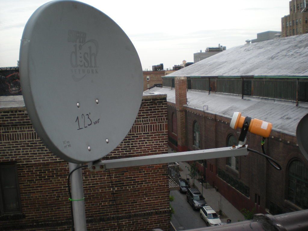

Not Sure if U understand .This is SUPERDISH (the old one) New Turbo is 1000.4 series and is a way smaller then superdish.
Iceberg is RIGHT.On the one YOU wanted to experiment with don't expect the same result as mine.
Tryed that way and on a clear day. Had up to 50 quality.It is not enough but still gives you some pleasure of getting a signal and experience that you going to need if U series about our game.
Good Luck!!
