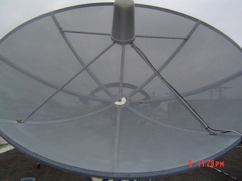

If the dish mesh is tiny holes instead of woven mesh and it has the AJAK H-H mount, my guess is that it is a Winegard Pinnacle.
Did it look like these?
If so, you have a pretty good dish! :cool:
Fred
If there are 8 panels it sounds like a Pinnacle perf - is it an actual mesh or perforated? Very good dishes and deep so the focal distance is critical.

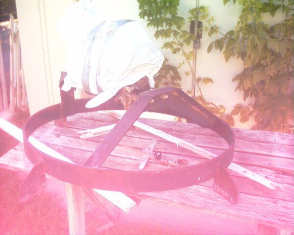

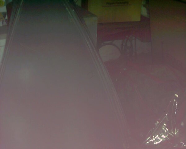

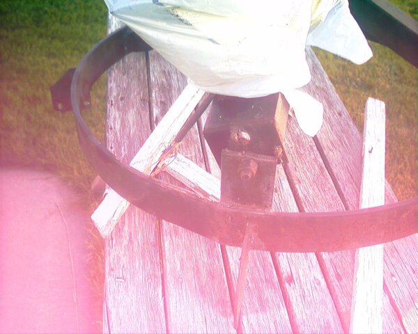

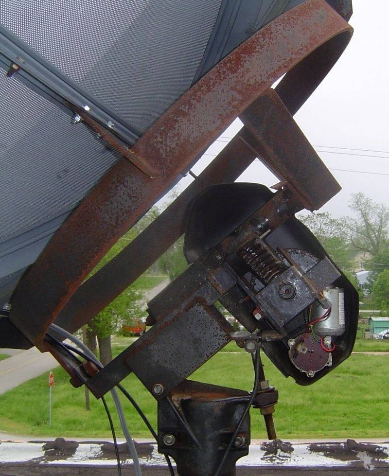

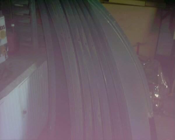

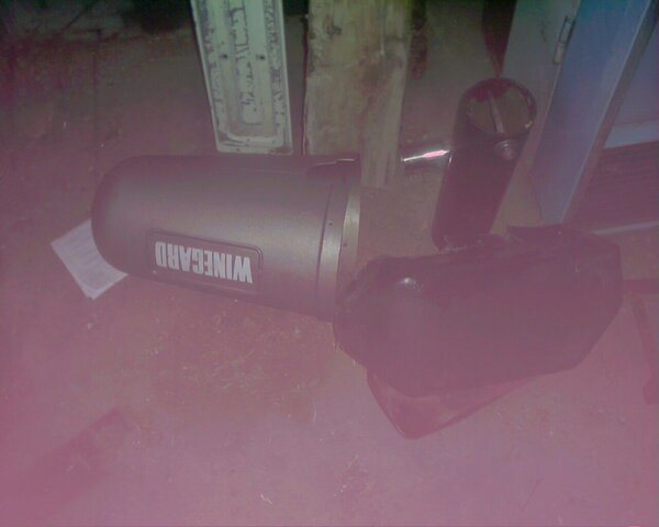

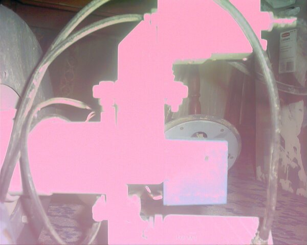

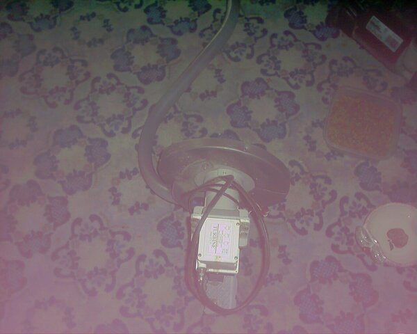

Pictures.
Yes, that does look like the critter. Heavey Monster of a thing. Except it had a single post comming out of the middle. But basicly looks liek the same dish.
Here is the pictures of it. After being disasembled.
later,
Josh

oh and I didn't know the difference
I didn't know the difference between the two. I just know them as mesh dishes compaired to solid one. Yes there is very very tiny holes in it and the panels pretty much pop back out to shape. So that is nice.
later,
Josh
Yep!
Looks like you have a Winegard Pinnacle with an AJAK H-H mount.
That is a great find, and a great dish. Can't tell from the pictures if you have a Chaparral Co-Rotor feed-horn or not. It looks like it. It takes a lot of patience to tune that thing in, but once you do, it will do a great job. It is a very deep dish, with almost no TI or side lobe issues.
I still have to put the final finish tuning on mine this fall and it has been up for 3 or 4 months already. :D
Fred
