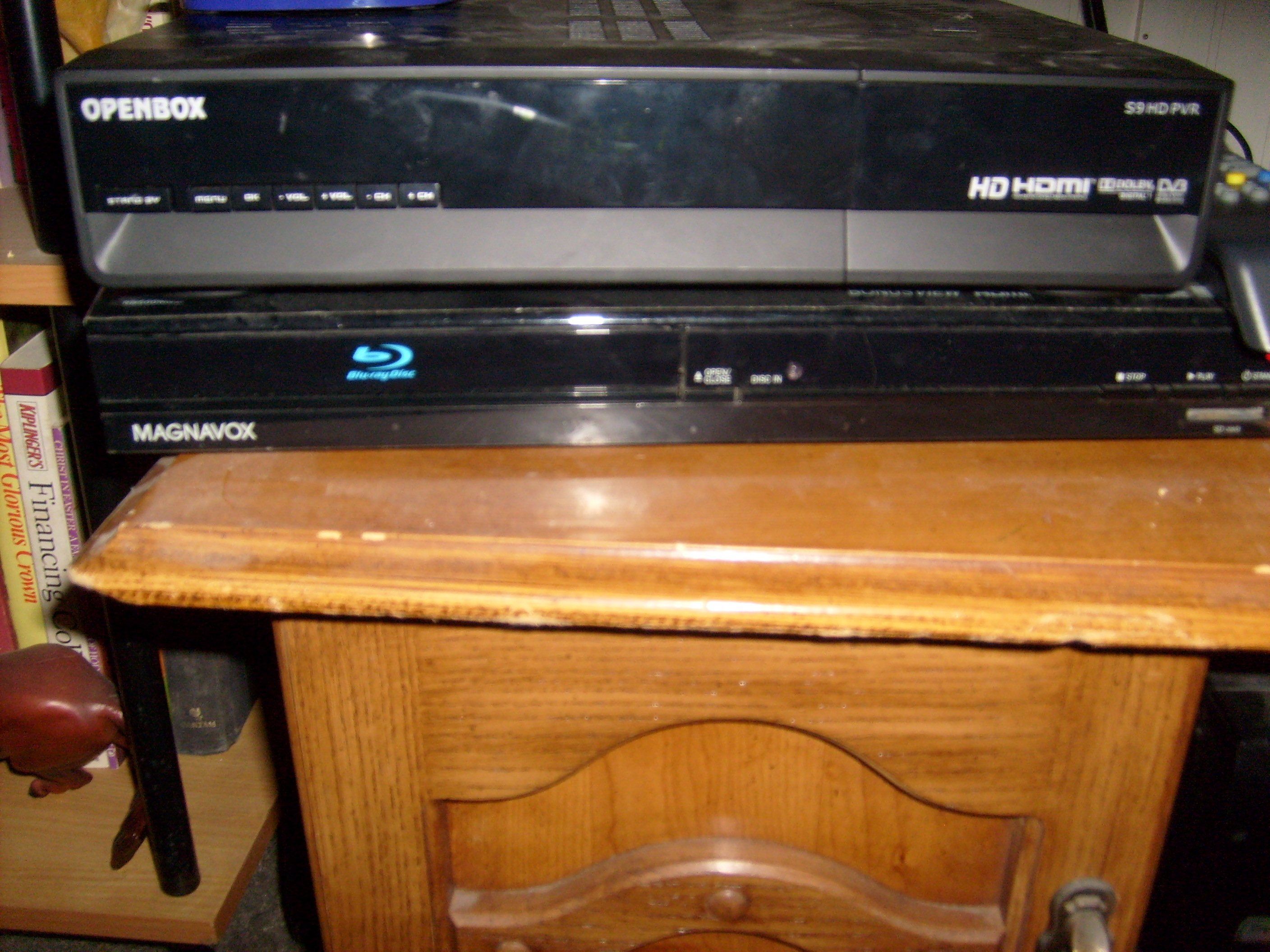

I would like to take suggestions for a new receiver. Possibly something that can be upgraded hardware wise and non clone as I think my s9 is one "not sure". As I understand a clone can be flashed ten times but I have done it way more than that and its not dead. I included a picture of it.
