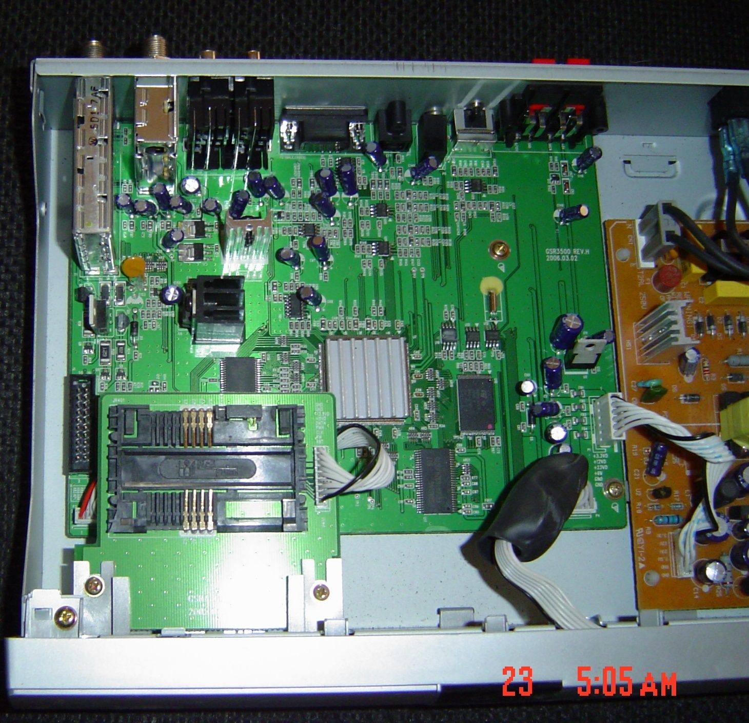

the one has some brown on it showing it was starting to leak a little.

Like I said on the phone, all those symptoms suggested something system-wide, which would have a sweeping affect on the receiver.
Something in common with all systems.

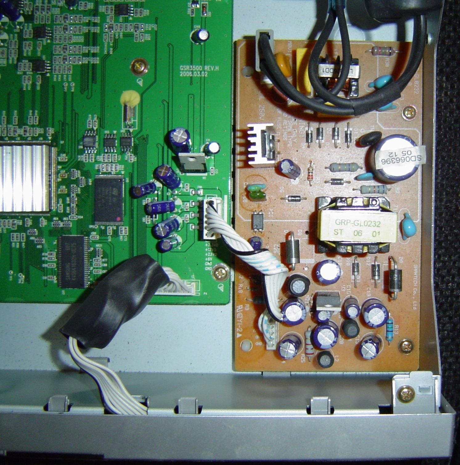

The caps in question (470uf@16V) were likely filters for the 12V DC supply. You could confirm this by tracing back from the +12V pin on the jumper which connects the power supply to the main board. Most likely failed because of already mentioned things, poor quality=cheap=puking all over the place and causing all kinds of glitches especially with digital equipment which likes a rock solid DC voltage. For some extra insurance you could install caps with the same capacitance value but with a higher voltage rating. 16V is the absolute maximum you can safely run through them.......no designer in their right mind would do that but 12V is actually close enough to make them fail if it's in a circuit with a high current draw. I know that you've already changed them but for future reference seek out maybe 470uf@25 or even 35V and you should never have to change them again. This is something I did on many TVs, the capacitor is the weak link in many modern electronics......it's one of the only components which really has no substitute with more modern methods. Unfortunately if left too long it can short completely and take out many other components in it's path!

Here are the numbers:
Old CAPS: GS (M)
85 degrees C
SAMXON
470uF16V
New CAPS: DIGI
105 degrees C
470uf 16V
The lowercase u represents a mu greek letter.
They are the same cap, size, everything, except temperature.
Fred
Hey Fred,
The 105 deg C are better as far as heat goes. Those bad caps were probably draging down the voltage or not taking out the AC ripple well anymore. If I had a dollar for each cap I've changed over the years I'd be a rich man.
