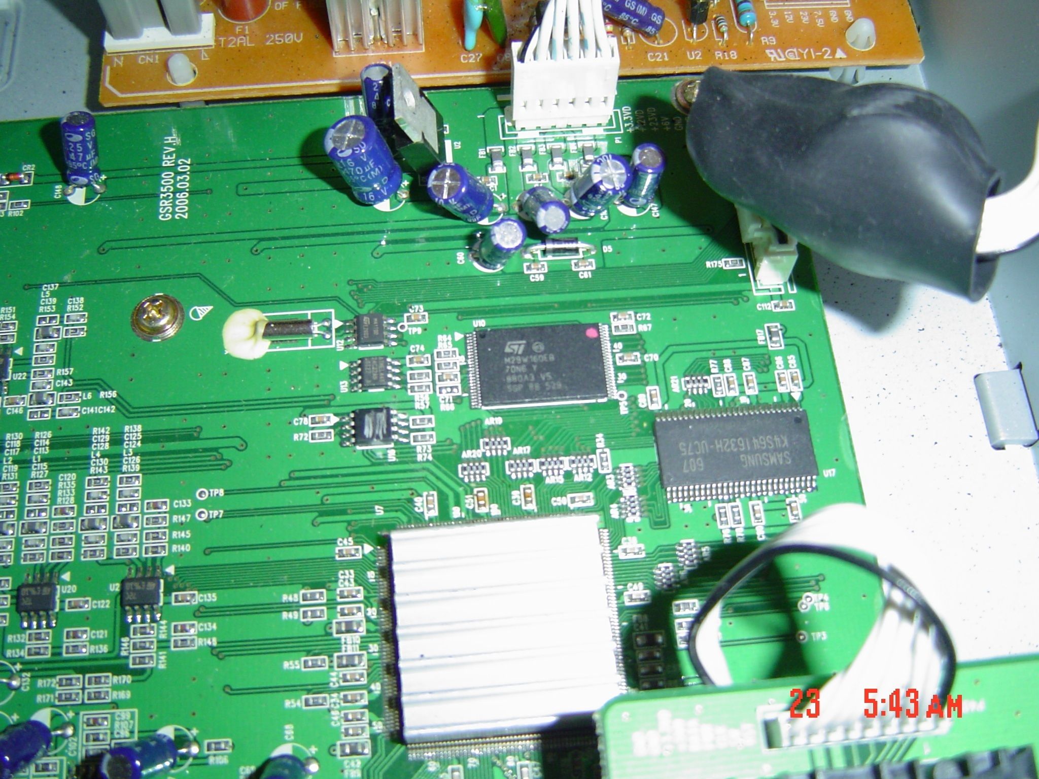

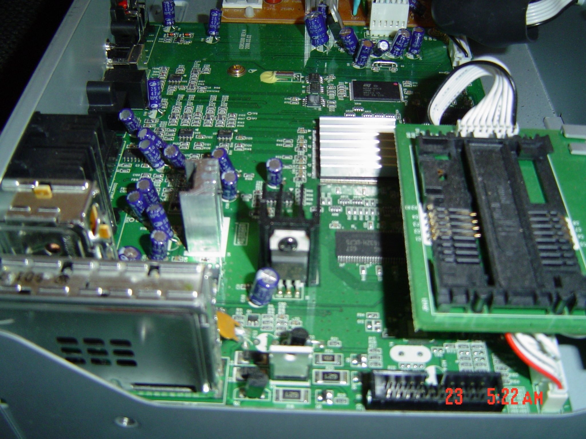

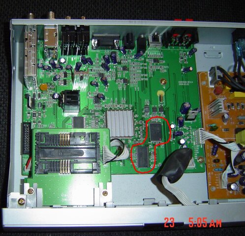

Here you go as requested. :)
Hope that lets you see what you need to see.
Fred
From your first image I would say that C14 looks like it is bad or going to be bad soon, I am going to wait to see what SatinKzo thinks too.
Normally if you replace the capacitors you replace both 13 and 14, it's not to hard to do.
So from what I can see you have a few options.
1. Replace the capacitors. (Might void warranty)
2. JTAG. (Might void warranty)
3. Return your Pansat for repairs to Pansat.
My recommendation at this time if you do not want to void your warranty is to send back to Pansat, otherwise I would recommend changing the capacitors.

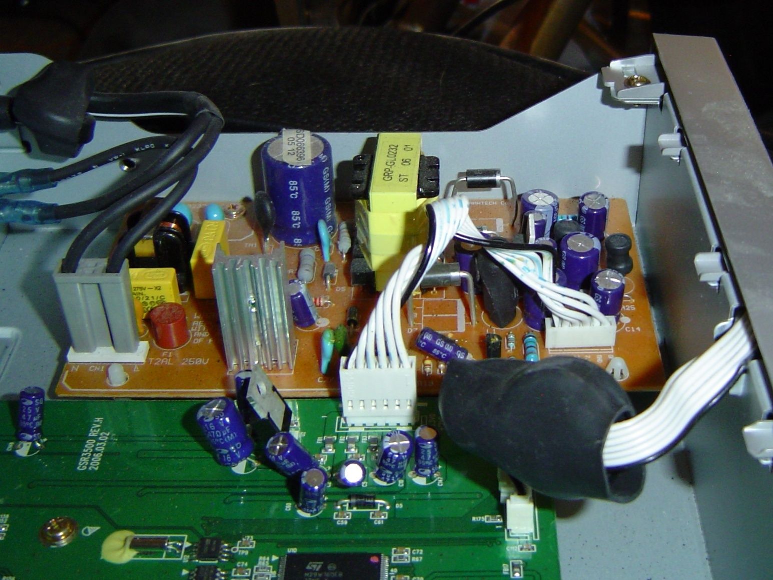

He means these:
yeah, that cap look to be going IMO. Everything short of sending it to pansat is gonna void it. heck I think even opening the case will void it, but I don't think pansat actually cares about that.
I think I would send it in. I might cost a bit, but not much IIRC.
There are a couple pansat dealers that do repairs also. I don't know if any of our sponsors do or not, but pansatdirect.net used to do them.
Edit:
yeah, pansatdirect still does them, but they charge $50 now. Used to be $25 I think
http://www.pansatdirect.net/usa/repairs.php
Edit: edit:
then again, replacing the caps is not hard and much cheaper then sending it in. :)

Probably a little late to chime in but yeah, C14 definitely looks like it's swelled. Can't tell from the pics but it looks like there may be some ooze from C13 as well. Probably best to change them both IMO. If you have a can of cold spray (or an upside down can of duster) fire it up with the top off, wait for it to act up and spray the caps down with some freeze spray. If it clears up then you know you've found your culprit. If it doesn't clear things up that's still no guarantee that they're not bad, but if it does work it can save some time/aggrevation.
Edit: If you have a scope you could check the DC voltages for ripple...........I'd be changing them either way just to see if it helps, but that's just me. I've been fixing electronics for 15+ years. Anyone with reasonable soldering skills should have no probleml doing a good job of it. The power supply board is only single sided so it's not too complicated.

Your power supply board doesn't look like it has been that well cleaned but tell me, what do you see on the board under C13 at about 1 o'clock in your pictures?

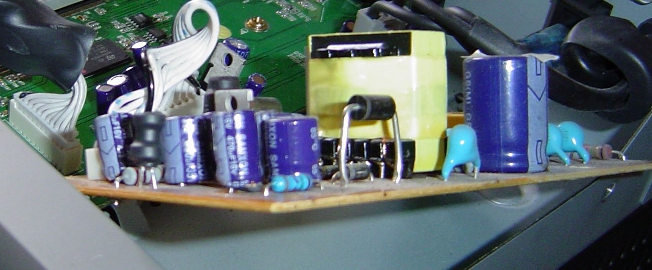

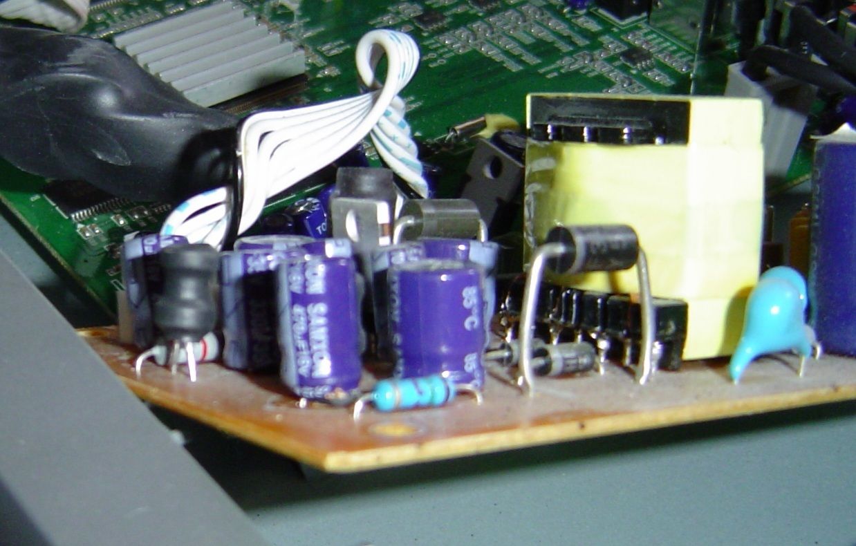

I don't have a scope, but I decided to stop by an electronics store in town this morning to pick up a couple of caps just in case. Well I had to get the numbers off them and in order for me to see them, I had to take the PS board out of the unit. Very simple two screws and two plastic retainers that you squeeze together and it pops right out.
After I got the board out, I saw the real problem and it is with C-13. Got the numbers and went to my client, finished up there, and dropped by the electronics store. The owner was a gruff older guy and when I asked if I could buy a couple of caps, he said "I'm in the business of repairing TVs, not selling caps. What are you going to repair?" I told him a satellite receiver. He said, "Well since it ain't tvs, I guess I can sell you some." I showed him the numbers and he came back with two and put them down on the counter. I asked how much, and he said don't worry about, so I got them free.
We talked a little while, and he apologized for being gruff and said he just didn't want any more competition or anyone taking away his existing business. We parted as good friends, and I am sure I can go back there any time and buy more parts. :)
He also explained about the positive and negative charge and how to find it on the cap and board.
I tried to call Panarex and no one answered the phone. So I am going to give it a shot. C-13 is definitely bad and almost leaking. The worst that can happen is that I have to pay another $40.00 plus shipping to have it fixed. As far as voiding the warranty goes, those who install improper firmware void the warranty, but they can still get it fixed for $40.00.
Take a side view look at C-13 at the bottom between the CAP and the board. Looks like it is ready to dump. :D

I can't tell from your current pictures.
They are a little fuzzy.
In the previous top-view pix, C14 appeared to be bulging quite a bit.
C13 seemed to be bulging less, but might have already crapped on the board.

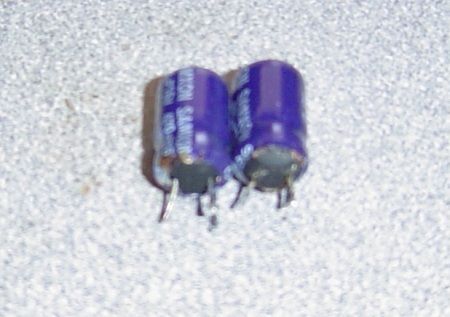

Here are the numbers:
Old CAPS: GS (M)
85 degrees C
SAMXON
470uF16V
New CAPS: DIGI
105 degrees C
470uf 16V
The lowercase u represents a mu greek letter.
They are the same cap, size, everything, except temperature.
Fred

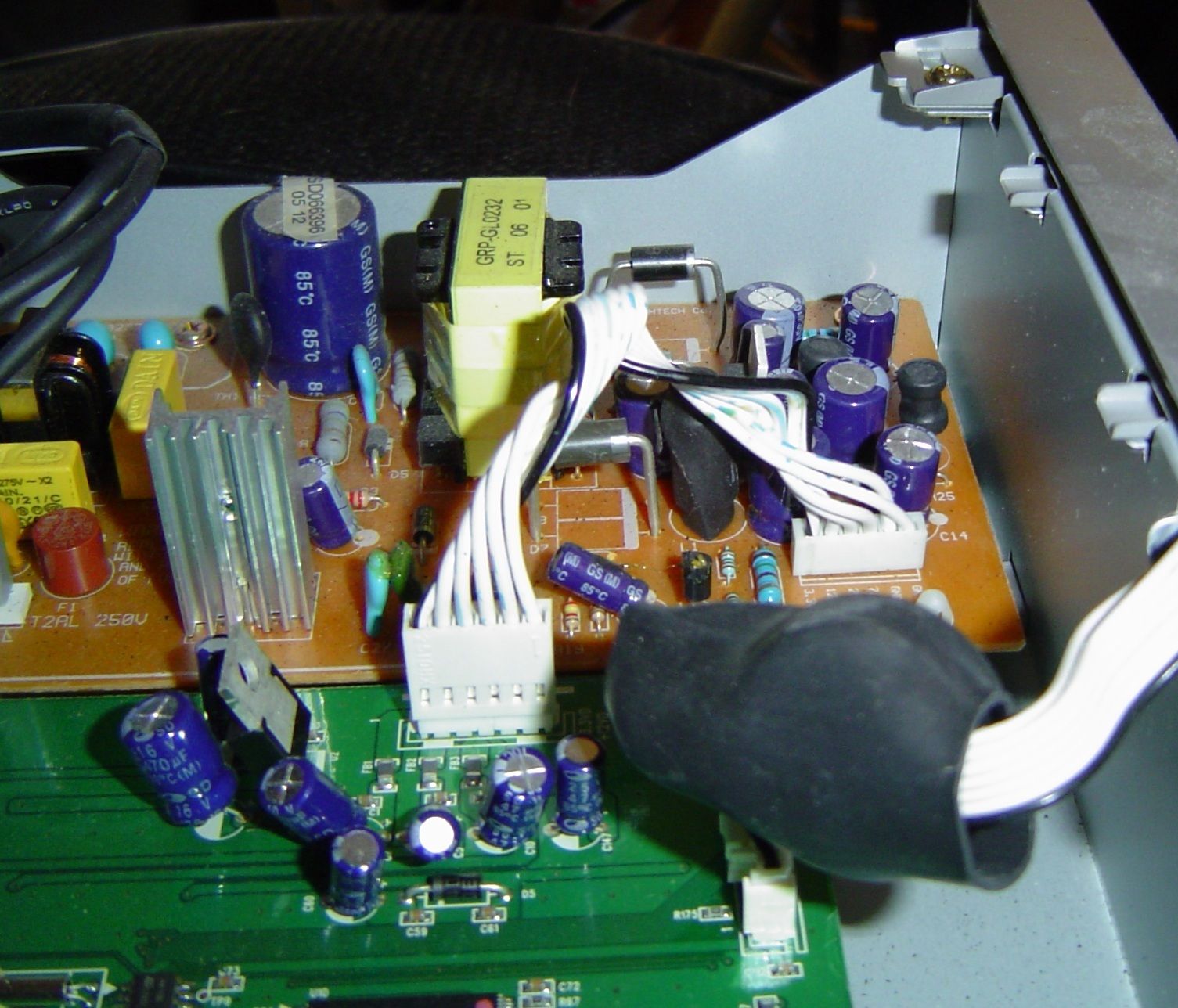

Here is a pic of the bottoms of the two bad caps. Sorry it isn't clearer, but the one has some brown on it showing it was starting to leak a little.
