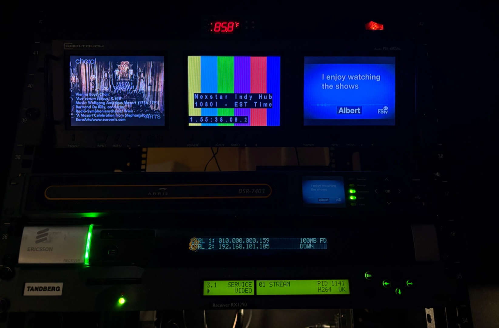

Our rack setup is mostly complete.
Tandberg RX1290
Ericsson RX8200
8 port gig switch with 2 gig uplinks
Sony AVR
Edision OS Mini 4K
Amiko h.265 receiver
Sgeyer 5-way HDMI remote controlled switch
Primesat PR1200 actuator controller
2 GTMedia V9 Prime receivers- one for KU the other for C-band
APC dual battery UPS
3-fan rack mounted cooling unit
