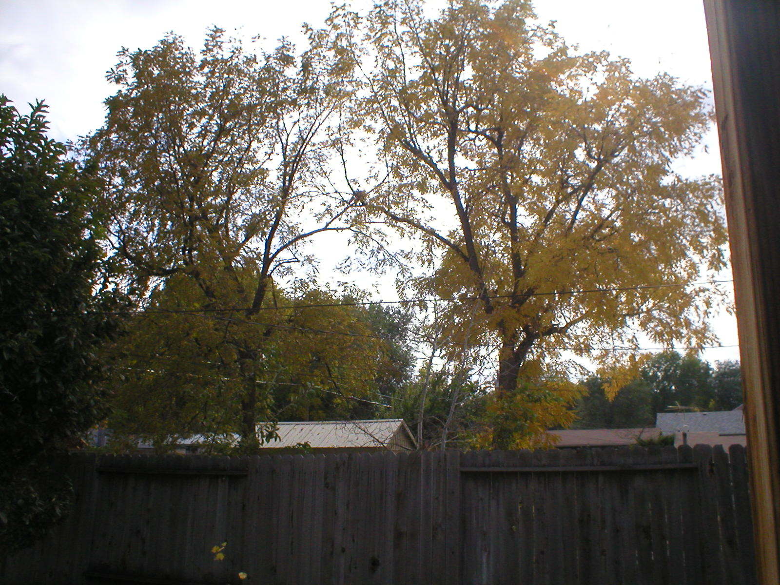

Could I have your expert opinion on these trees?
My azimuth is somewhere in those sparse trees. Think I'm safe? After all, 90% of the time I use this dish they won't have leaves ;)
how far away are those trees and how high?
By my best estimates, about 70 feet away, and somewhere between 50-80feet tall (not so good at estimating that)
I guess I could just try, but I'd rather not have to drill holes into my post only to have to take the dish down and move it right away.
oh, i see where you're going. with simple right triangle trig, we can tell if i'd be aiming over them. Well, at a 36.7° elevation, it doesn't seem like it.
