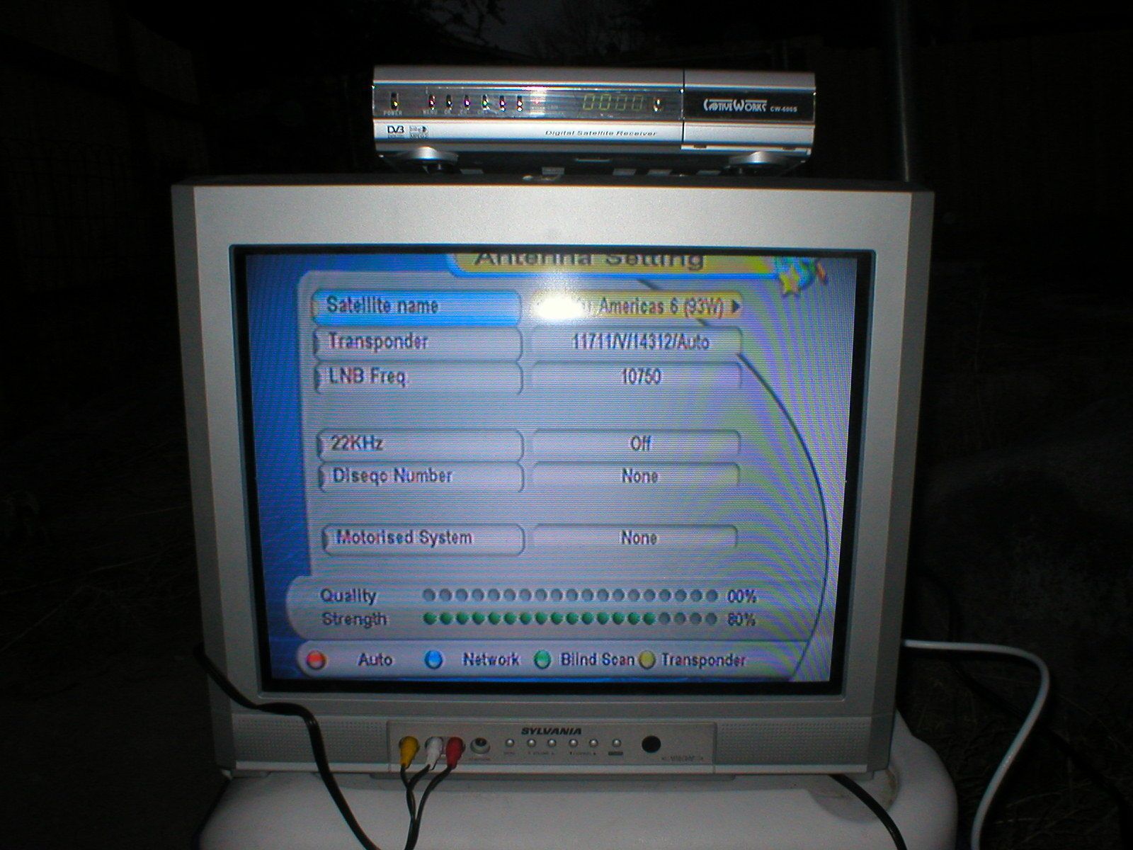

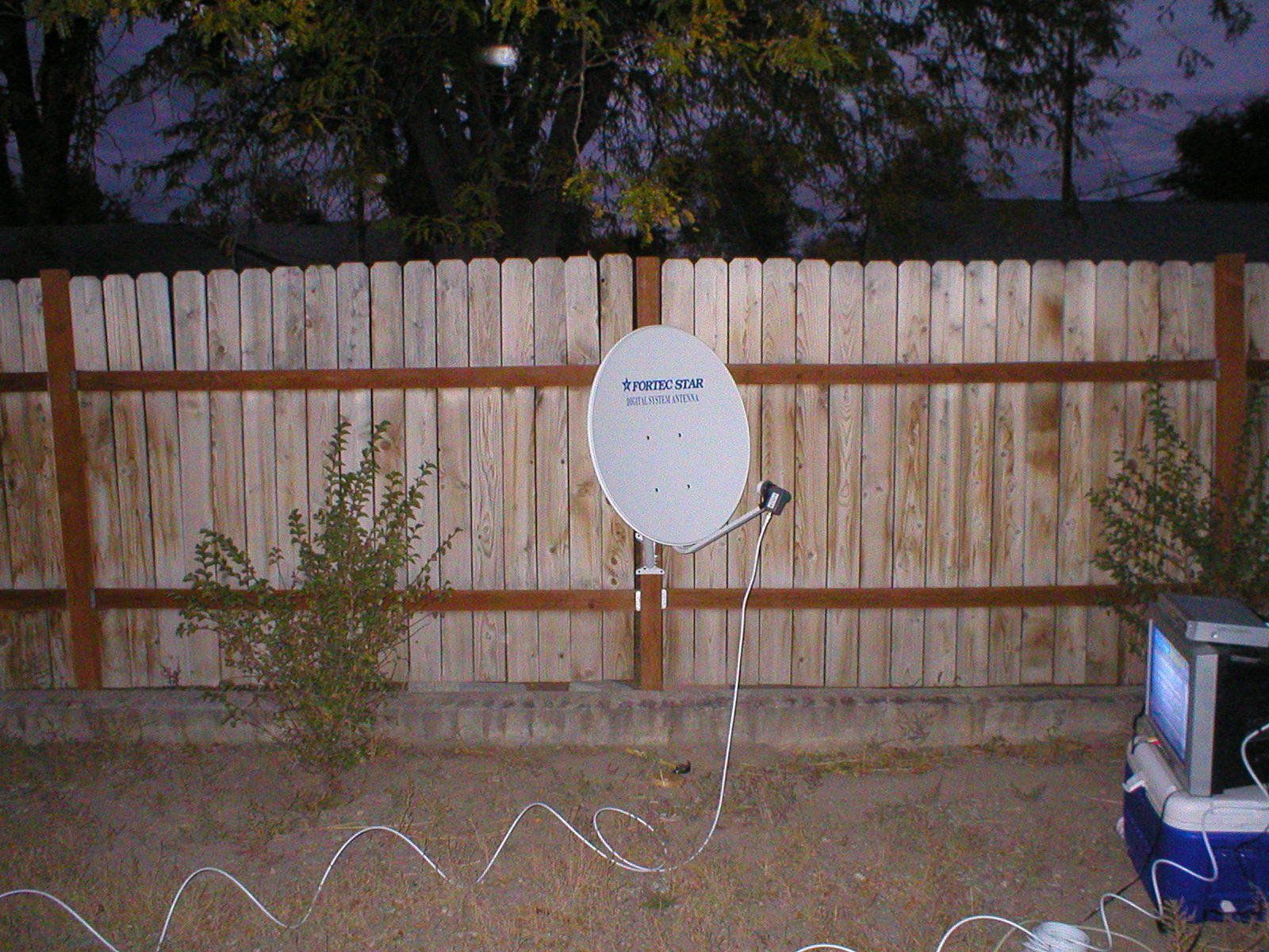

Thanks for lending a hand. I followed the coordinates from geosatfinder, but i did have a hard time finding 141degrees. The compas I got goes wonky when it's physically near (a few inches from) the dish, but i know i'm pointed in the right general area.
I took some pictures, maybe that'll help.
setup screen:
photo taken facing south (lnb is skewed, didn't help)

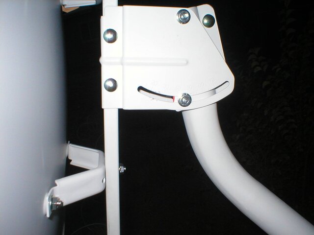

elevation is set in the neighborhood of 37 (got the signal to peak at 80 at this elevation).
Well, it's getting dark and starting to cloud over. time to haul my junk into the house and try again tomorrow.
ARRRGHGHGHGH!!!! :mad::mad::mad:
thank you for pictures :)
The settings on the box are right :)
The skew is right :)
looks like it may be the elevation...try and lower it a little bit at a time. Looks like its aimed in the right place but that little bit of elevation can make a HUGE difference

the signal means the LNB has power. I've noticed the signal moves when I'm on a satellite and moves higher when I'm close but the elevation may be off...right now I was aiming my 6 footer for a satellite and the elevation was off. signal showed 85 but 0 quality...dropped the elevation a smidge and 85 signal 70 quality so you are probably close.
Once you hit the right info that is on the satellite the quality bar will move. Digital you need to be right on or the signal wont come in. If you feel you're close scroll through the satellites and transponders and see if you hit anything. Below is a list of the strong transponders on each satellite. 93 is good because its smack dab in the middle of about 8 satellites that have stuff on them. 87,89,91,95,97 all have stuff on them 24/7 so if you're close you may hit one of them.

It may be the picture is not taken exactly vertical - but it looks like you mast is not exactly vertical. If the mast is off vertical - then the dish elevation settings will be incorrect.

mast not plumb; tiny compass
Please re-read what WescoPC posted above about your mast.
I just read the thread and noticed that situation and was about to make the same remark.
I actually have one of my dish masts off-plumb by 15º..20º , too.
So, it's not impossible to get working, but it'll make the suggestions given by others in the thread a bit harder to follow.

You can see why we were concerned:
Based on the incorrect assumption your camera was level... *
- the pole is leaning about 10º to the south (?)
- dish is tilted down another 1º, so that'd put dish elevation at about 23º, when the picture was taken.
Since you used a plumb bob (weight on a string), I'm sure you're within a degree or so of plumb.
And that should be fine for a fixed dish.
I do worry that your fence post is wiggling.
Will the wind make the fence and post move?
The dish will certainly catch the wind.
Not that you can't get on a bird and see some TV, short term... :)
Of course, if you should decide to go motorized in the future, then plumb is the law!
And wiggle is not permitted.
* I got out my angle finder (tilt meter) and did the above measurements from your photo.

Iceberg, you had mentioned that the fortec dishes are off in their elevation markings? what direction? I'm i'm really pointed at 85W, my dish is reading quite high, the marker is right at about 40-41°
oof da...that is really off. I've seen usually high so 35 is really 30. But you are on the right path
