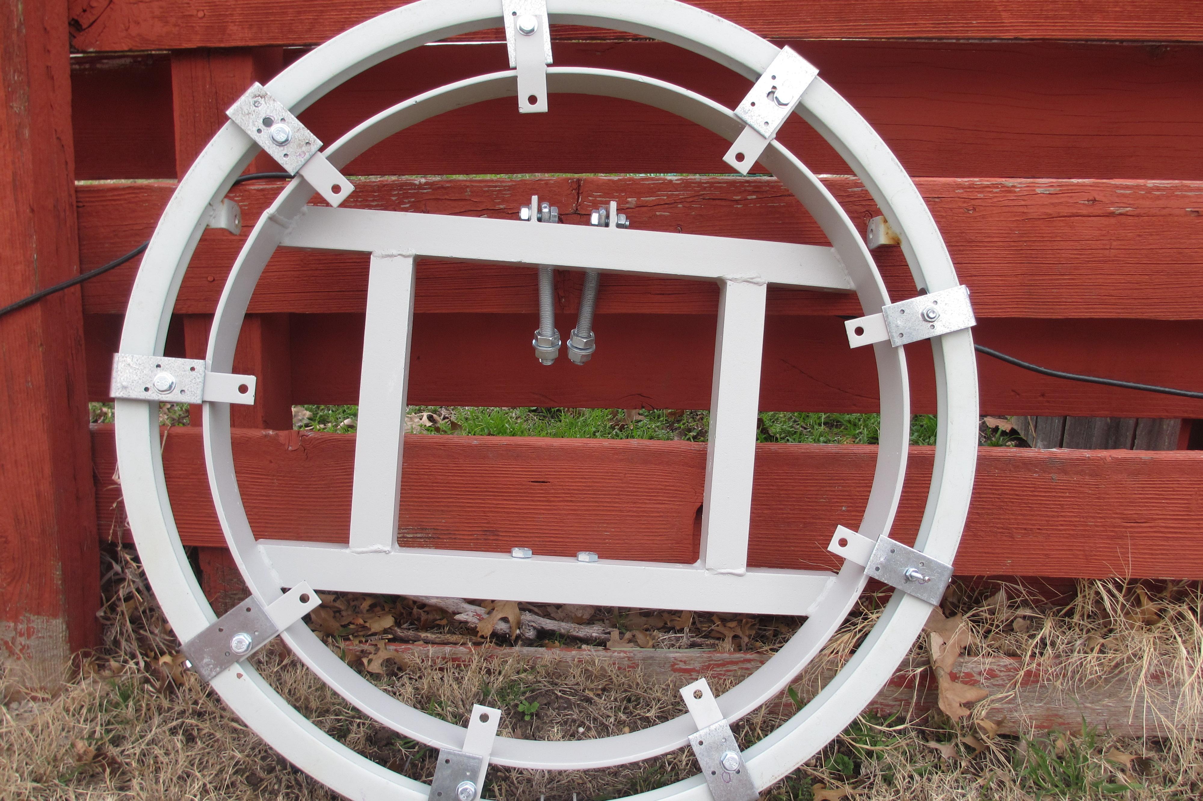

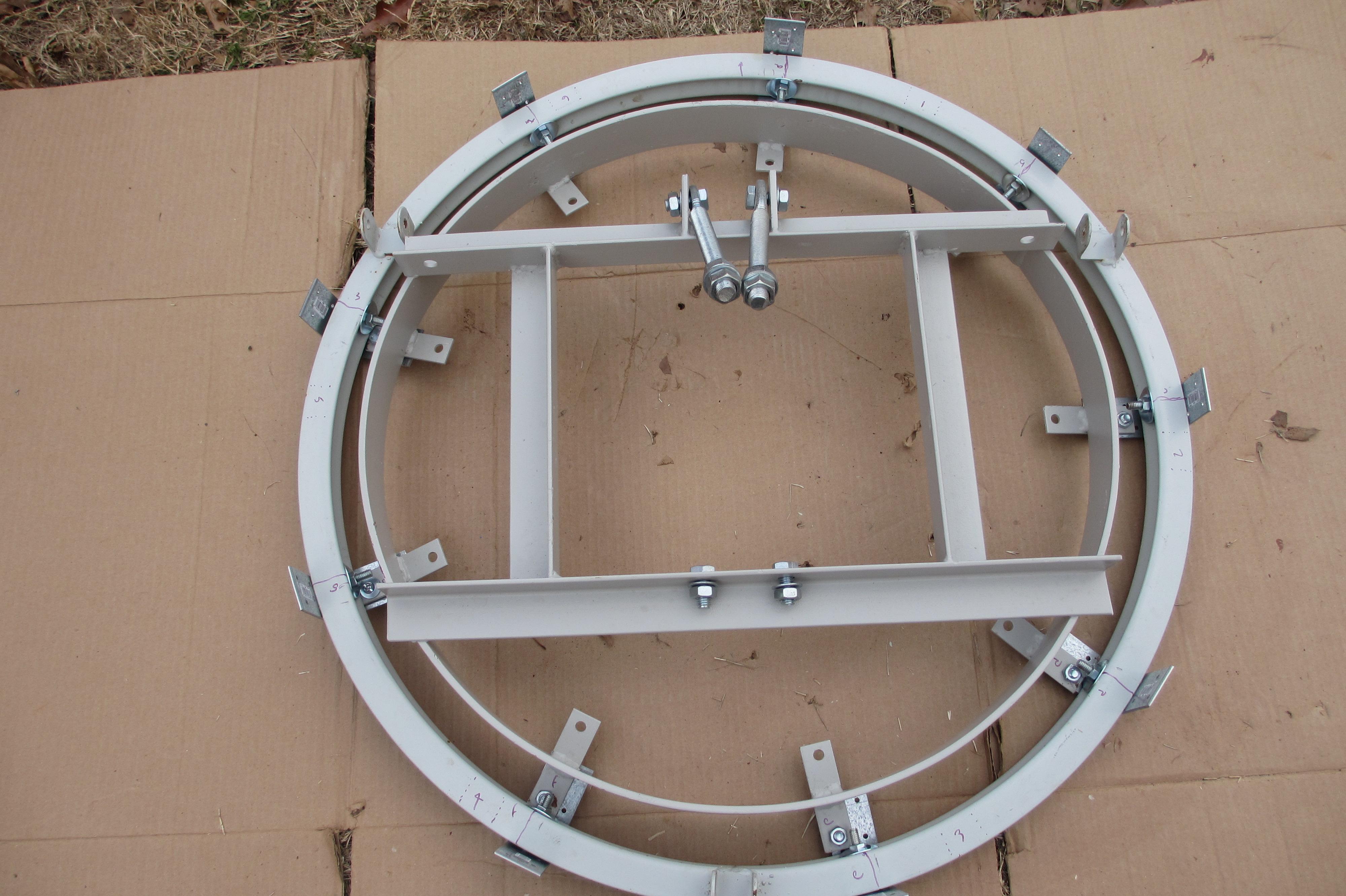

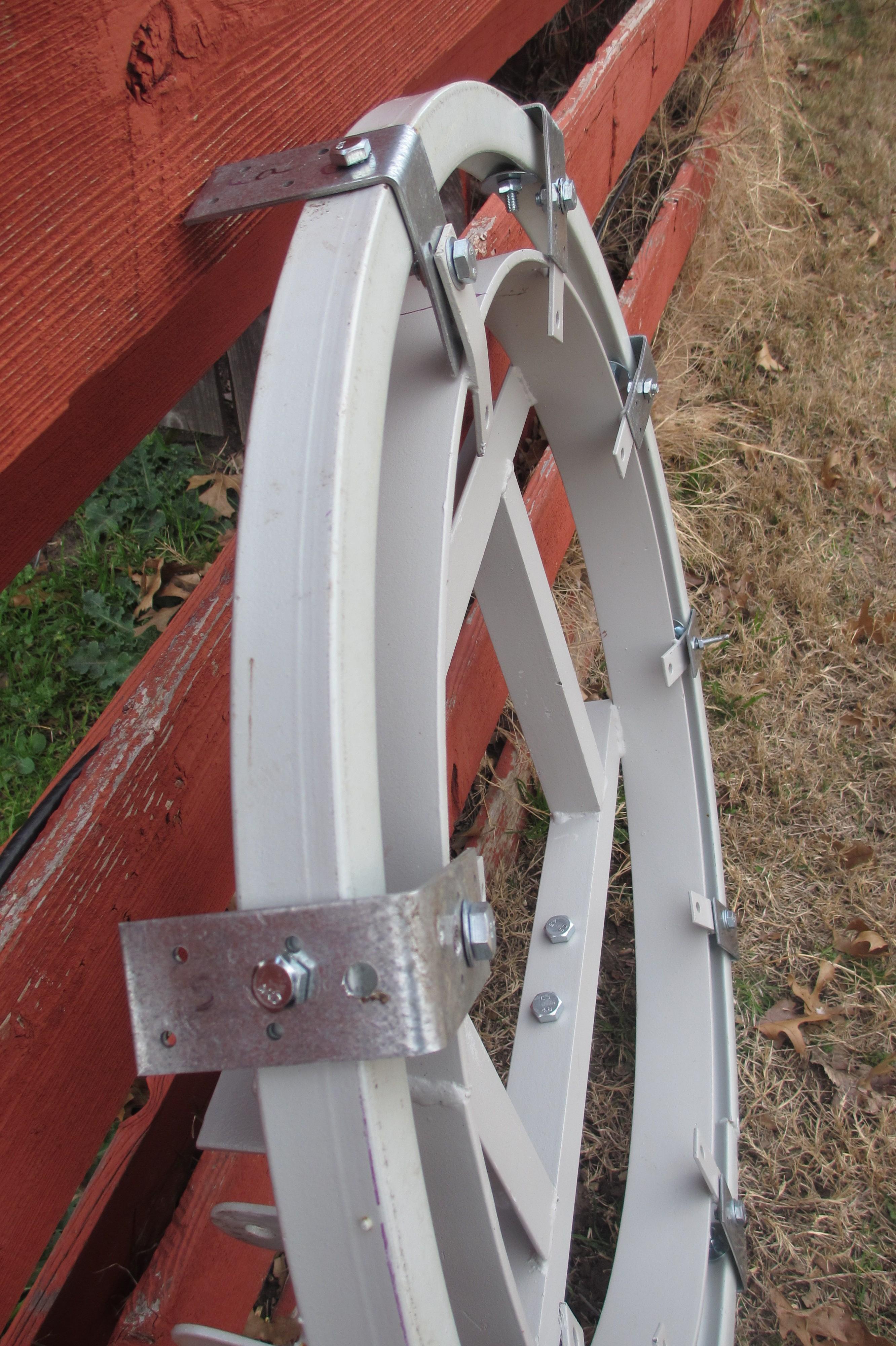

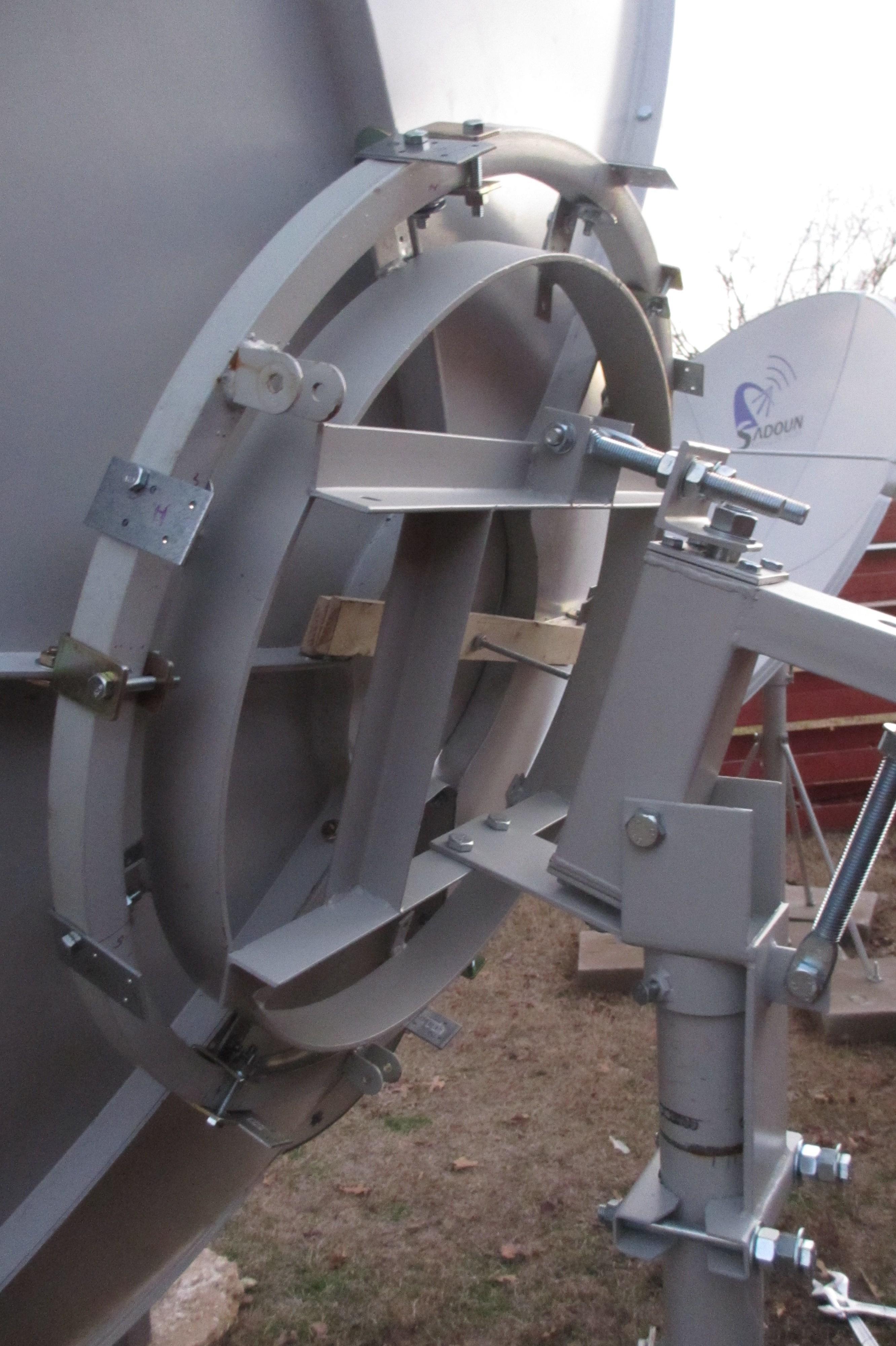

Right now I have done the attachment the Big Ring of the Wsi international with the sadoun ring Mount . I have spent a lot time to do the Holes and strap the "L" metal because i did slow calculations to assure the centered each other.

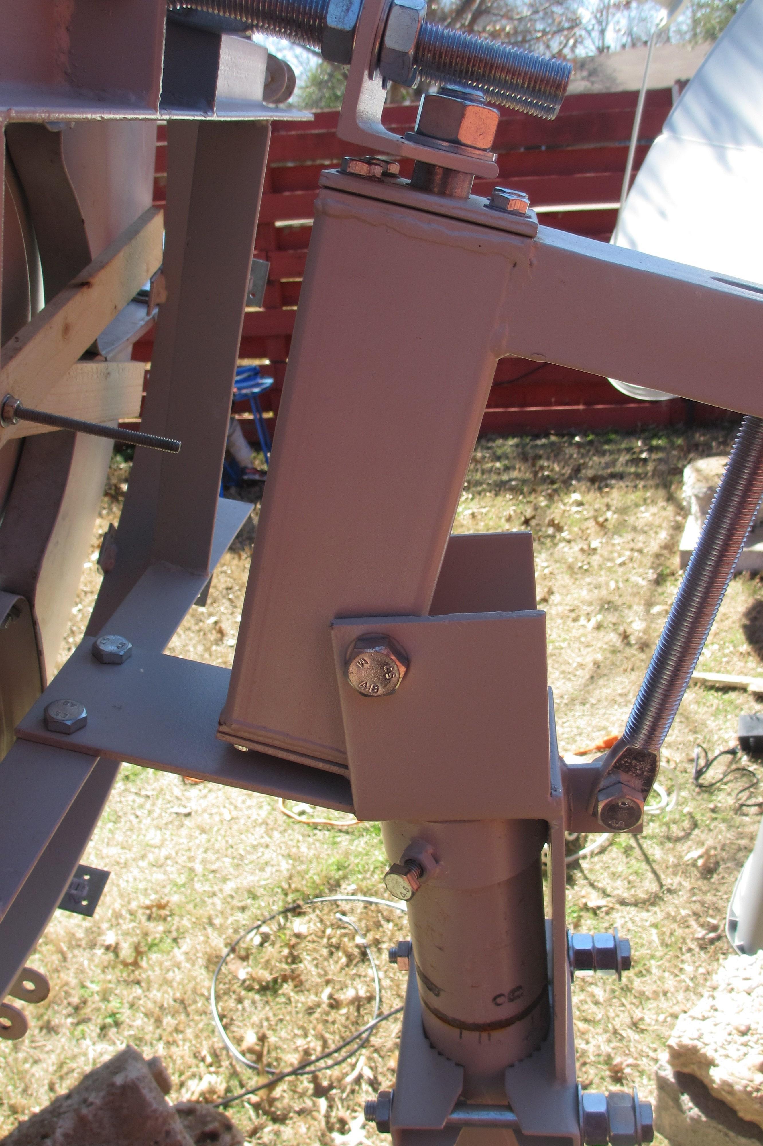

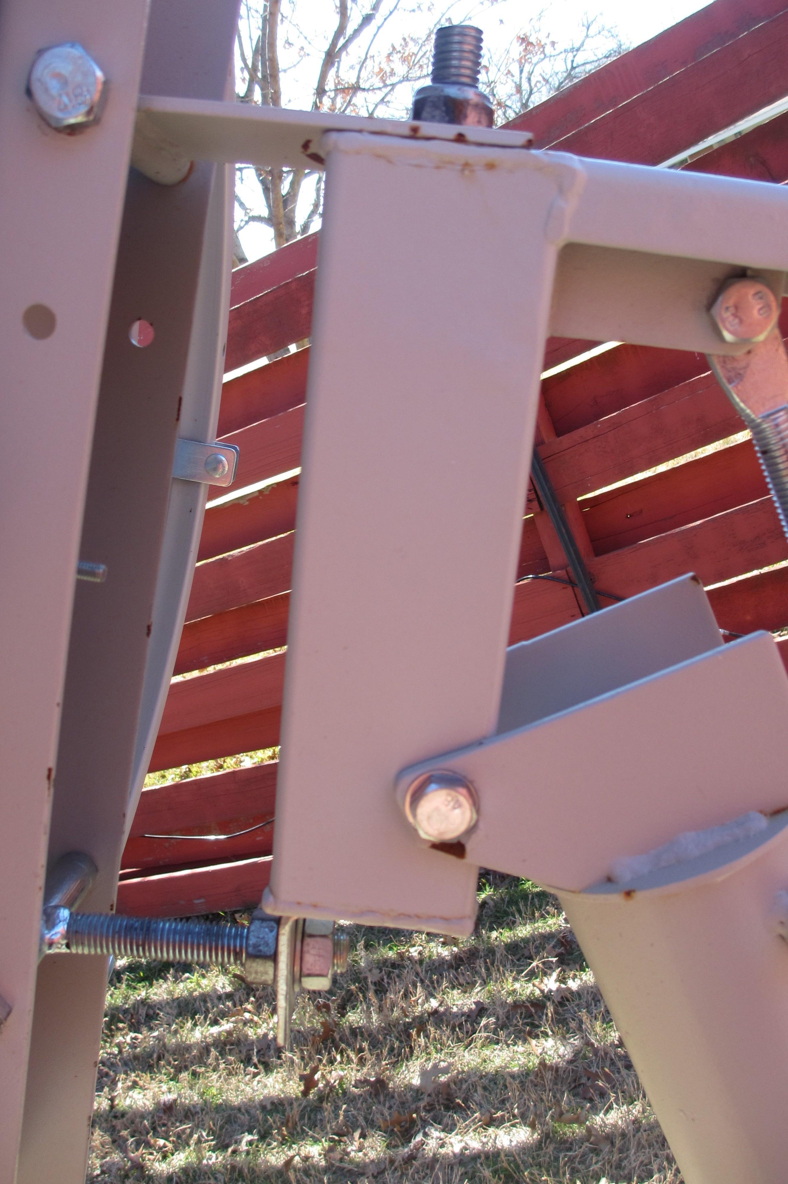

I have mounted the sadoun mount on the Dish and then put everything on the sadoun 39" pole mast pipe.

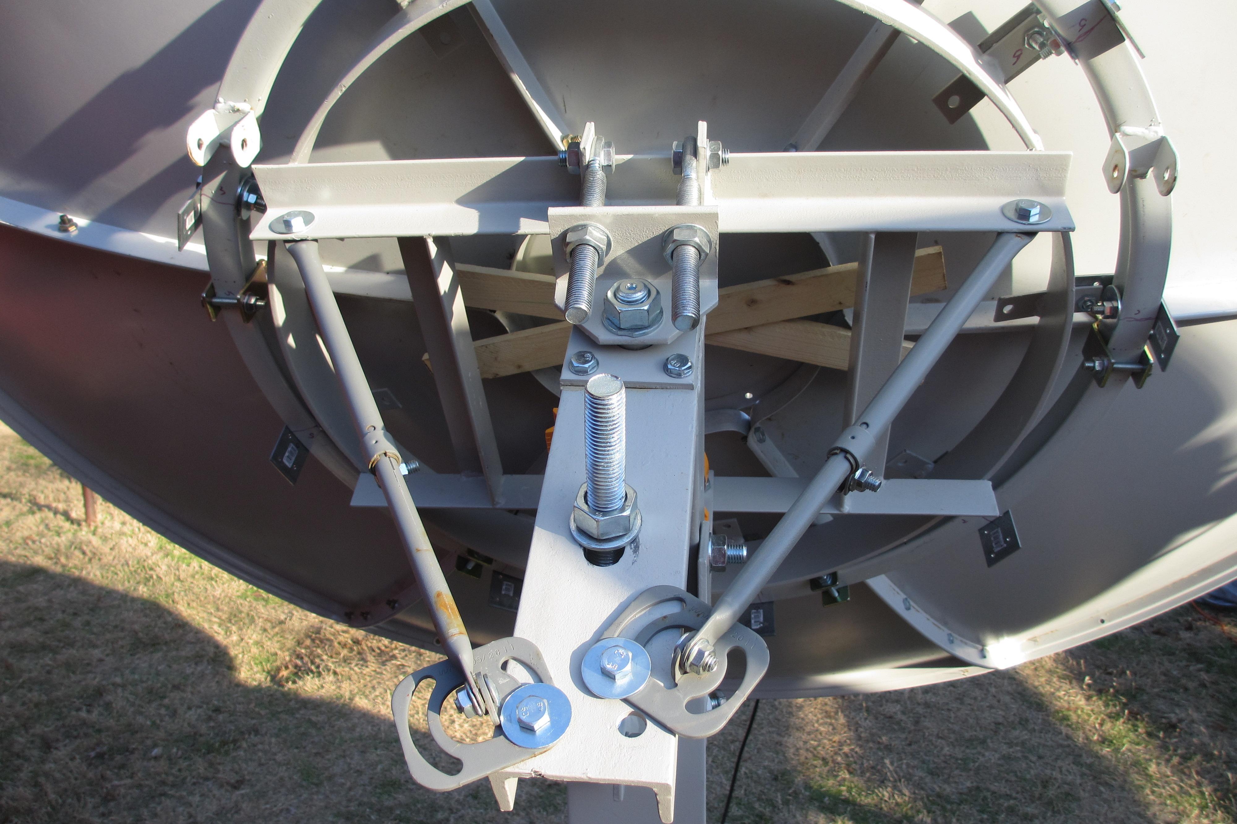

I have to admit that this stuff is very "Heavy" I recommend to put with 3 persons or more. So the next step is to put the LNB arms and start the testing
Pictures speaks
Comments are welcome!! 02-08-13 096j.JPG02-08-13 001A.JPG02-08-13 002b.JPG02-08-13 086C.JPG02-08-13 088e.JPG02-08-13 089f.JPG02-08-13 091G.JPG02-08-13 095i.JPG

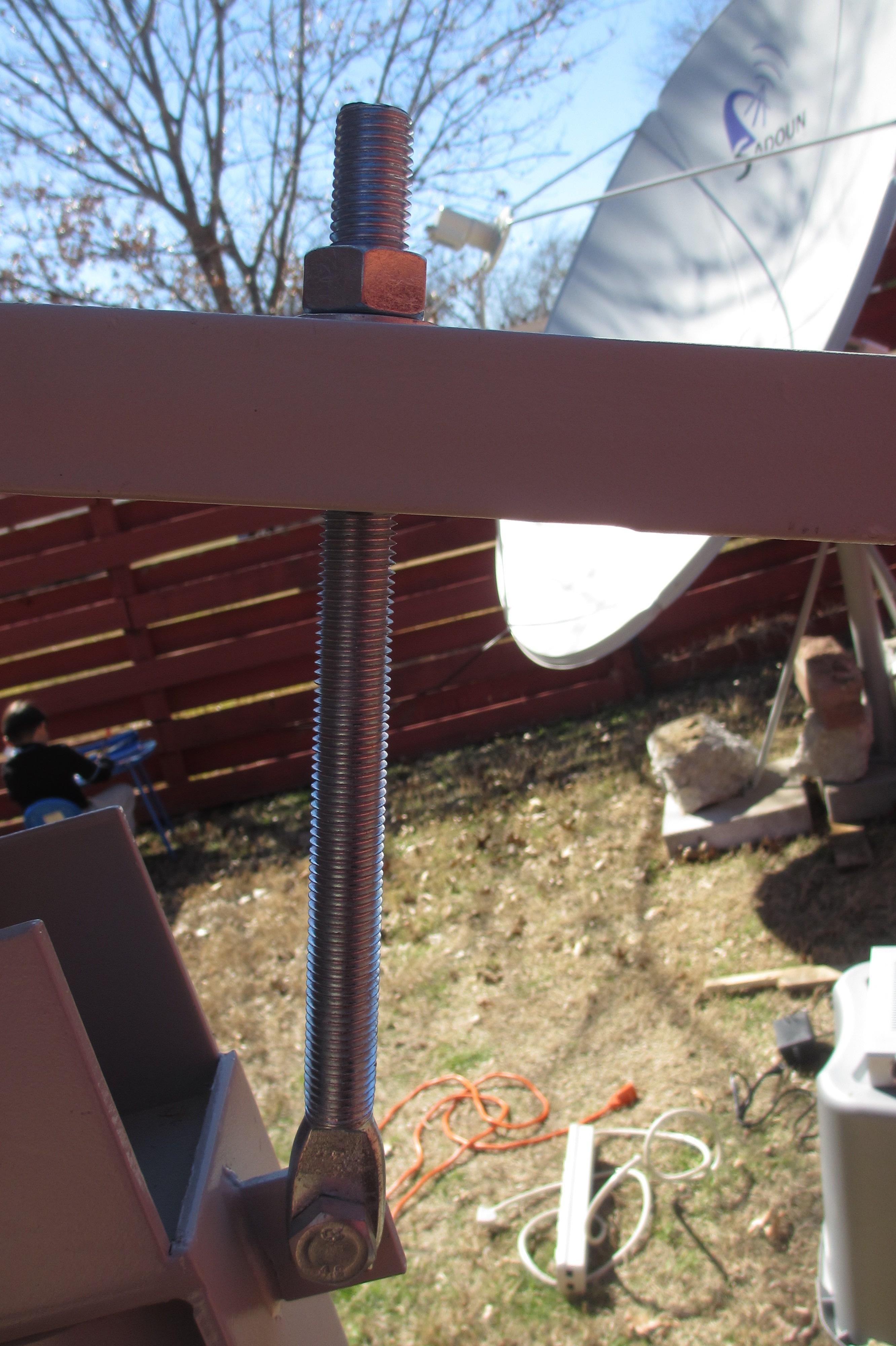

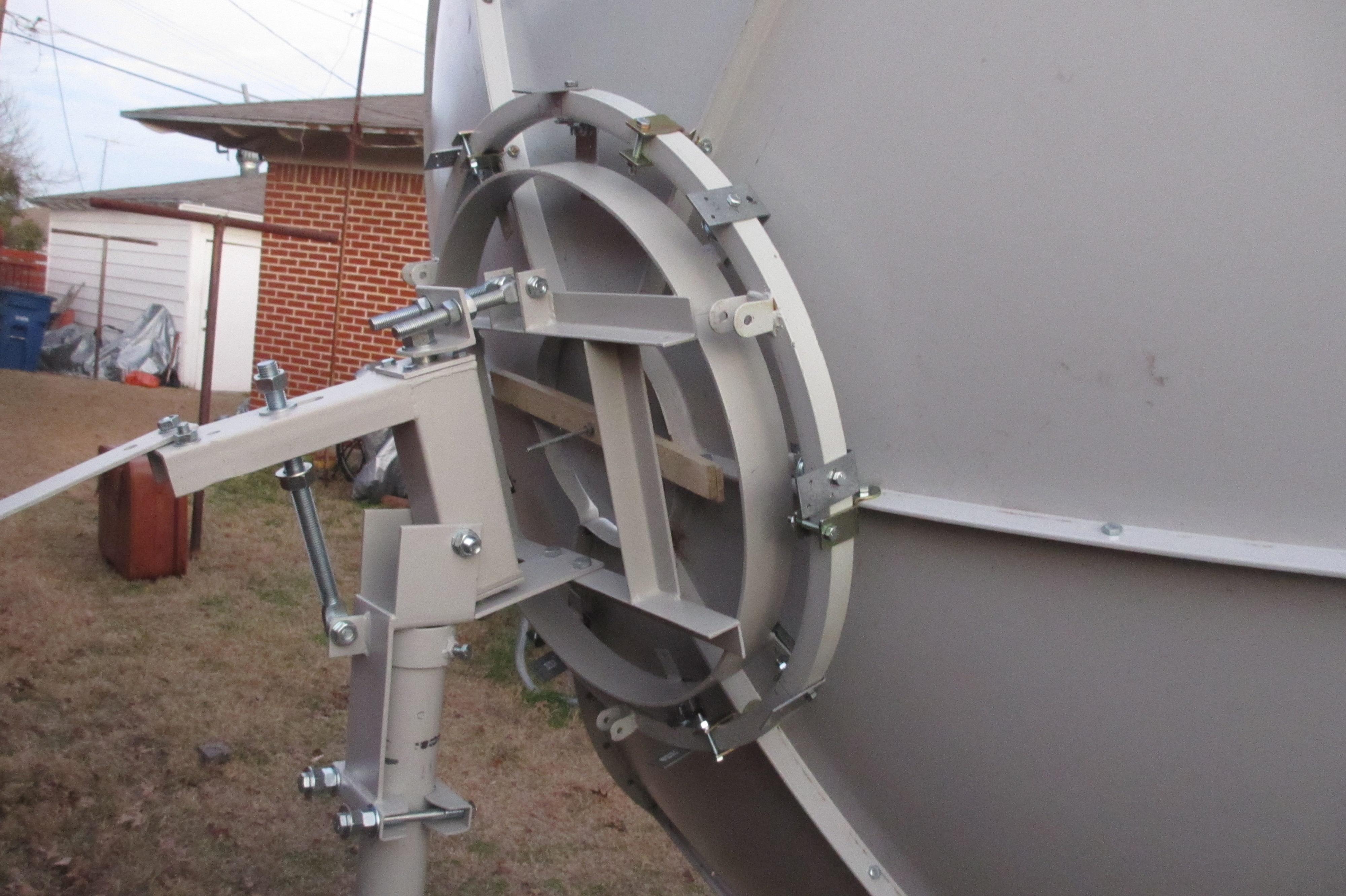

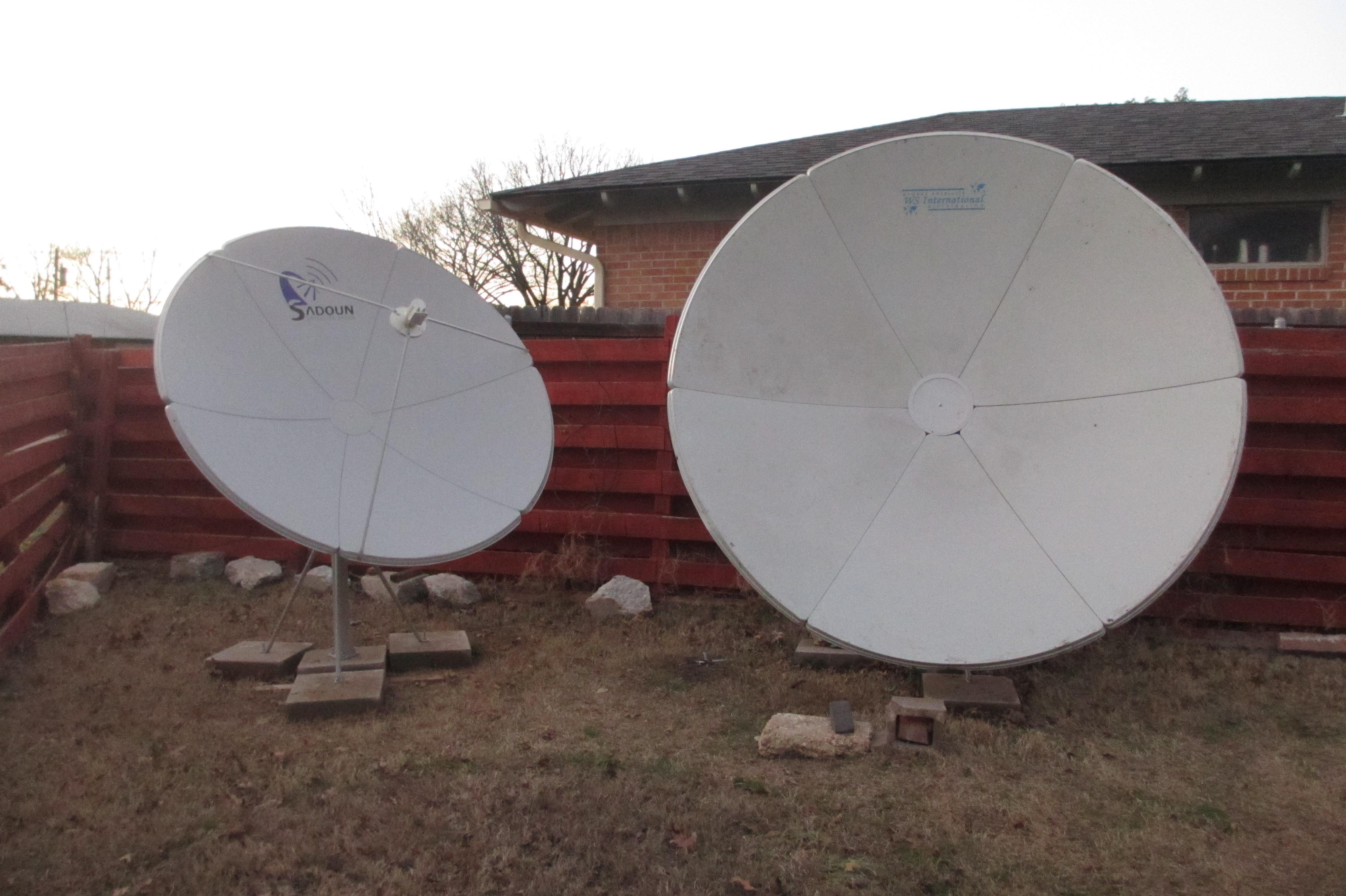

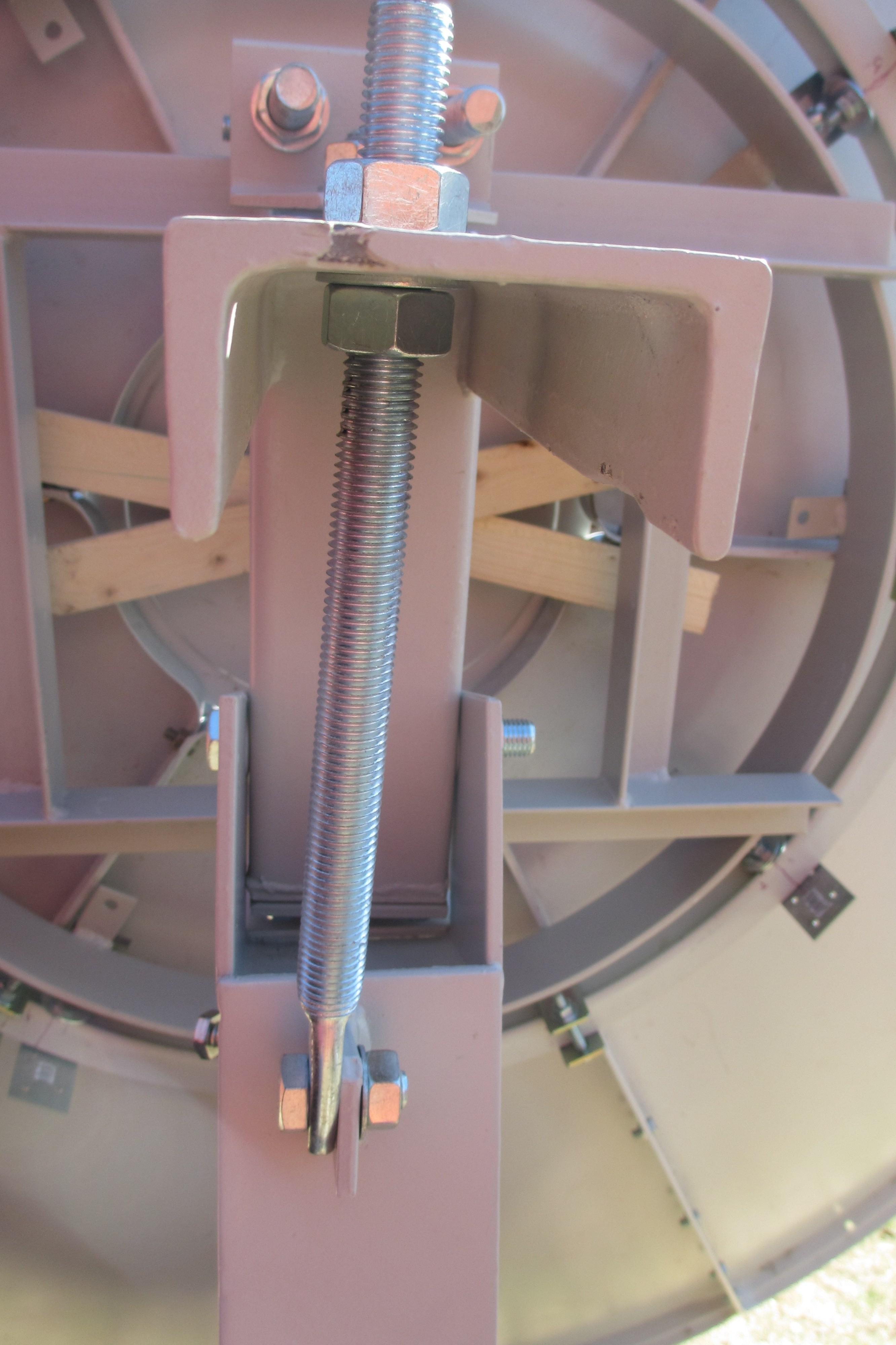

I don't have yet an actuator so I started to test stationary-manually on one specific satellite. My objective was to aim at intelsat 21 at 58 W C band.. so I set the Azimuth and elevation according to my position. After set the Azimuth I have noted that the Sadoun polar mount SP240 pm with the WSI antenna is moving through the arc east to west and if you put in one position and if you are trying to keep in hold through to tight the big Nuts (on the azimuth set) is moving anyway (picture 1a and 1b)on 6 ft you can keep in hold the azimuth set after to tight the Nuts (picture 2)

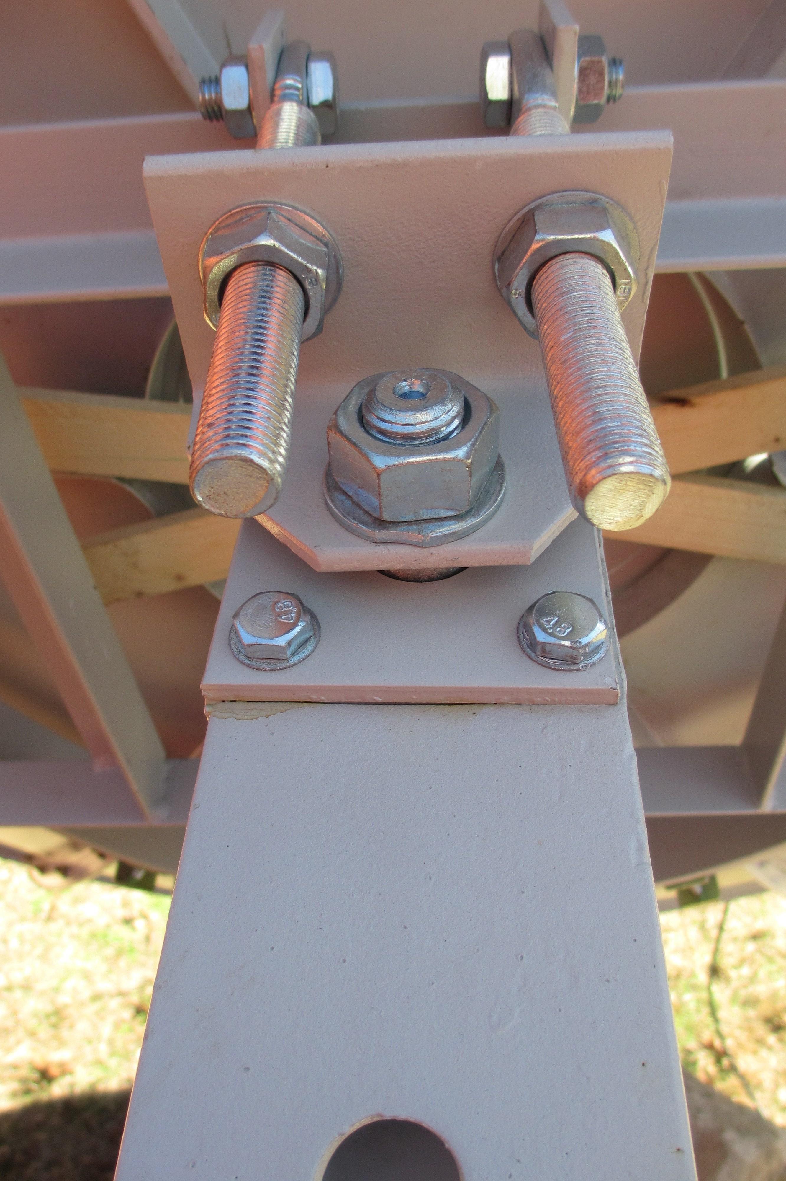

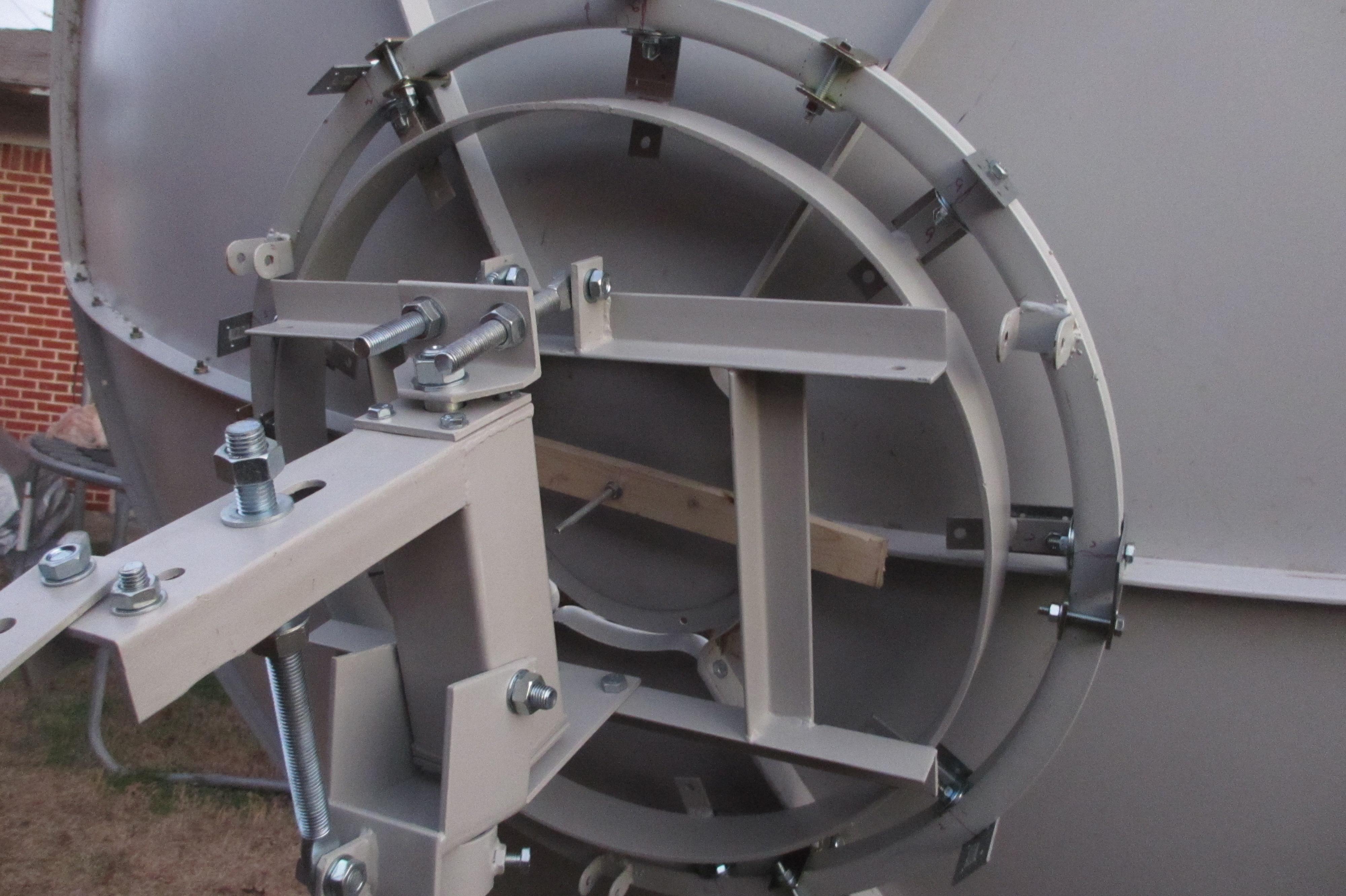

So to keep in hold the Azimuth set I have installed 2 DTV support arms is was not easy because the wind was strong (picture 3a and 3b).. So after keep in hold the azimuth and elevation adjustments and LNB adjustments the signal came strong. I have noted the improvement signal reception on 58 w signal compared to my sadoun 6 ft so these numbers are tell me that this mofification is going on good way..
Question ? Anybody knows whats going on about the Azimuth set? Why after tight the Nuts the dish is Moving (east-west), I never heard about that any big dish works only with Motor or actuator..or Maybe something I need to know about the Sadoun Polar mount SP240pm.

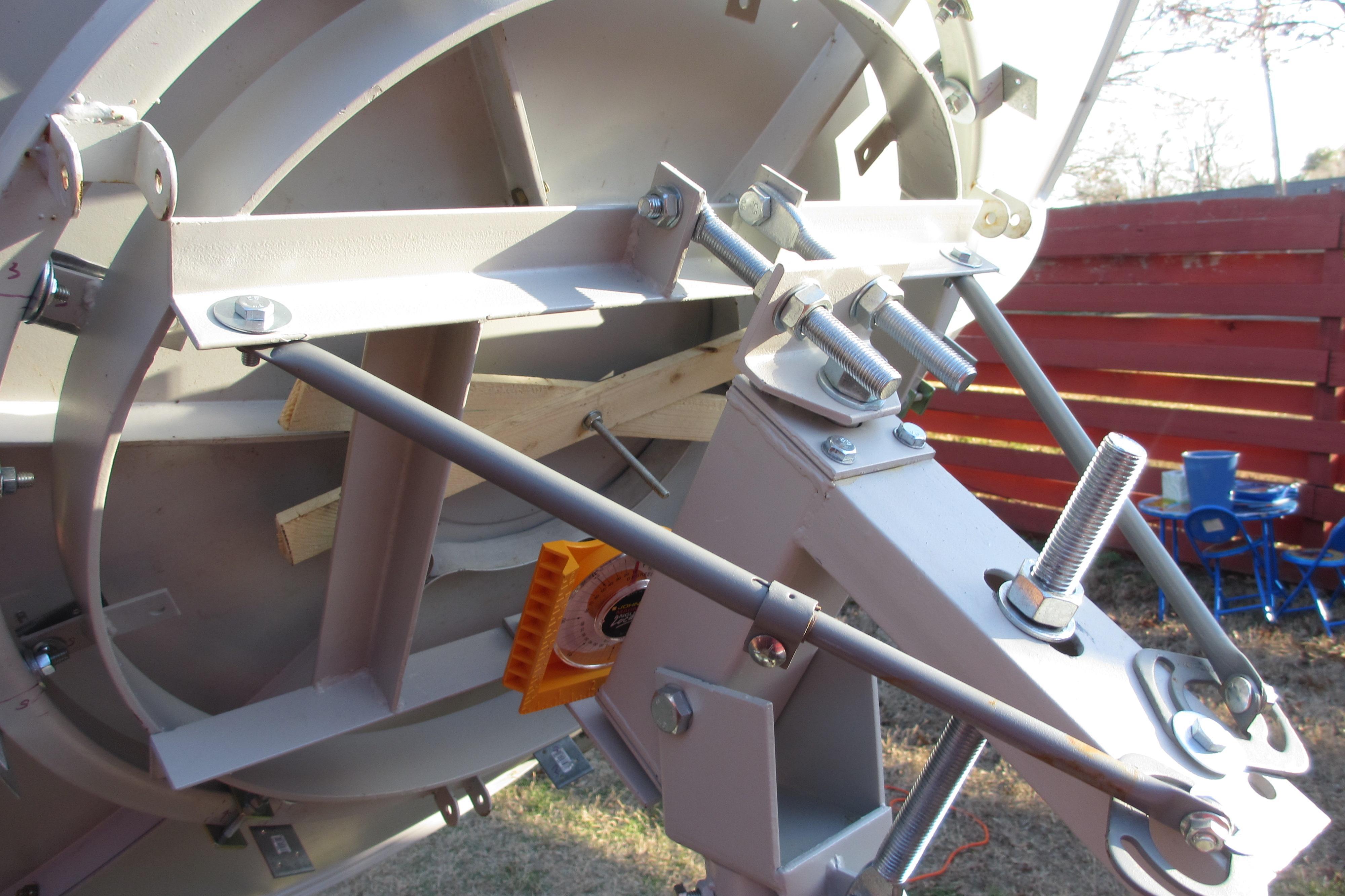

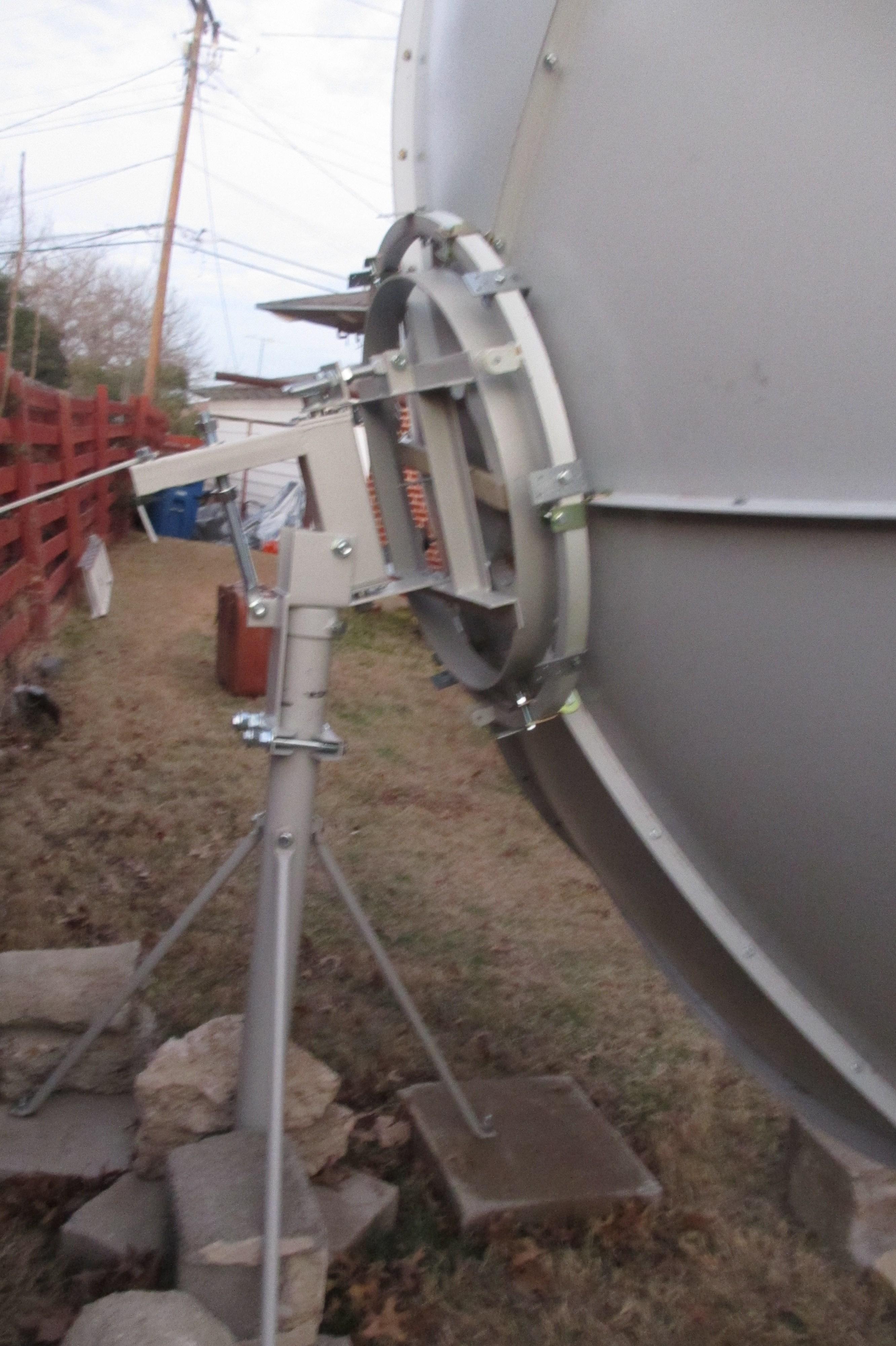

Another observation on this was that while the elevation set is low the azimuth antenna is not moving, only moves when I started to set up the elevation like 30 degrees and up.(picture 4a and 4b elevation set)

It's a polar mount, it's made to move back and forth. You will NEVER be able to crank the nuts down tight enough to stop it from moving by itself. It NEEDS to either have an actuator, OR you can use a long piece of angle-iron with holes drilled in it to "lock" it into a certain satellite. Mount the piece of angle iron in place of an actuator. I have done that in the past, and it works fine provided everything else is set properly for the polar mount, as if you are using an actuator.
Just make sure the holes drilled correspond with the length needed to point at the particular satellite you want.
Maybe I'm misunderstanding you but,the entire purpose of a polar mount is so that the dish will move and track the arc with an actuator,be it manual or motorized.
Azimuth,elevation and declination are set once on installation and then left alone.Once set properly for your location the dish will then move and track the arc with the actuator.
If all you want to do is lock the dish down on one sat you would use an azimuth/elevation mount.You then have to readjust everything if you want to point at a different sat.
Primestar beat me to it,I type slow.:D
Thanks primestar31 you are confirmed what I experimented on my set up
Thanks Waylew..
Yes sounds Crazy!! Why this guy has done everything for just one satellite :rolleyes:....
My plan is to get an actuator in the future. I am just testing my project to see the signal reception;)
I seem to remember a while back, one of these dishes shipped with a metal strap.
You put it where the actuator goes, if you don't have the motor (yet).
So, that's how it is - and well explained above.
