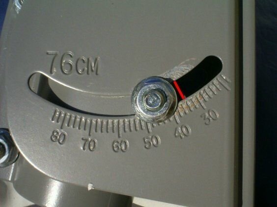

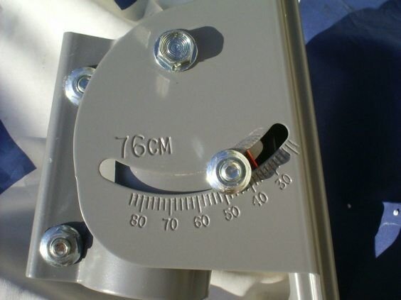

My manual says that my declination angle on the dish should be 30 deg.
Later on it says that based on my lat (74) it should be 23.4. Probably accounting for the motor post angle, so which is it?
I hope it's not 23.4, 'cause I can't get there without modifying the post.
Thanks
What kind of motor and dish?
If its a Winegard DS 2076 dish make sure to use the RED line when setting the elevation....

Winegard 76m dish, H-H DM-910 motor, Viewsat Xtreme receiver.
Thanks, the book does not explain the red line marker.
So I'm setting it for 23.4, which I'm assuming combined with the motor post angle, gives me 30 deg.
Back on the roof!!!
Thanks again,
Bob

oh i forgot to add
most motors (elevations) are set to latitude and and then set the dish elevation which for you is probably that figure of 23.4 so there are two sets of elevation one for the motor and one for the dish.
