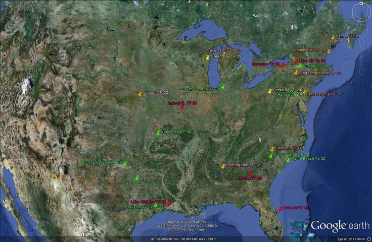

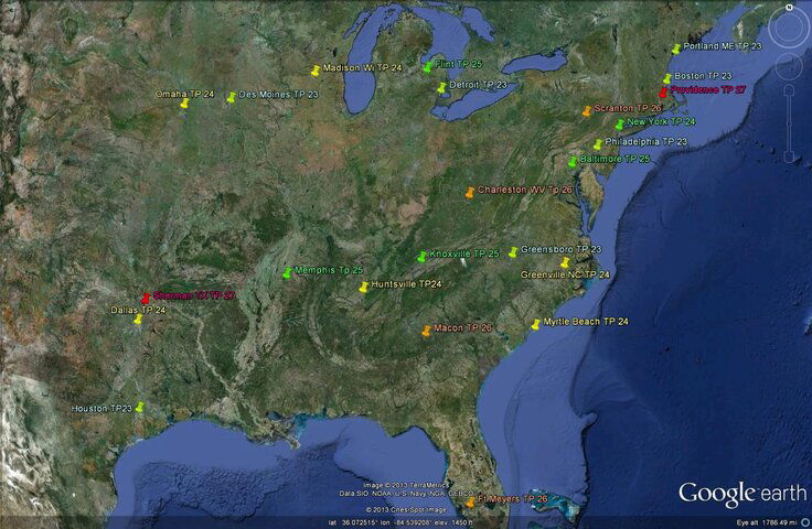

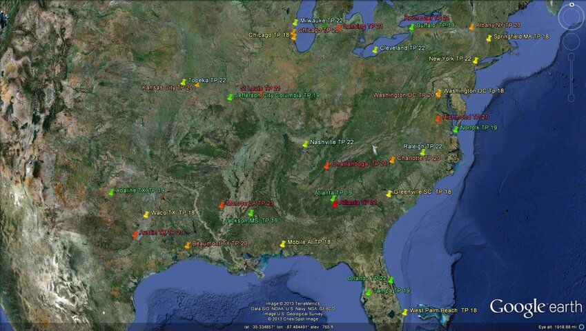

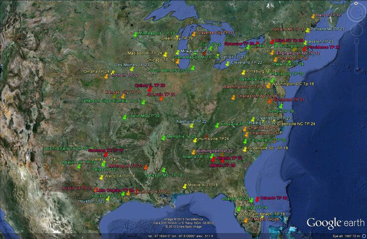

I put together some photo shots of the transponder reuse for E16. One composite and 3 segment photos of the 15 transponders and the markets they are expected to serve. The photos illustrate how any given transponder is reused multiple times by separating the markets served geographically. Ten of the markets are served by 2 transponders, with the remainder having one transponder service.

Thanks, how soon will there be a list of tps, spots, and markets for us inquiring minds? Is that what digi is working on?
