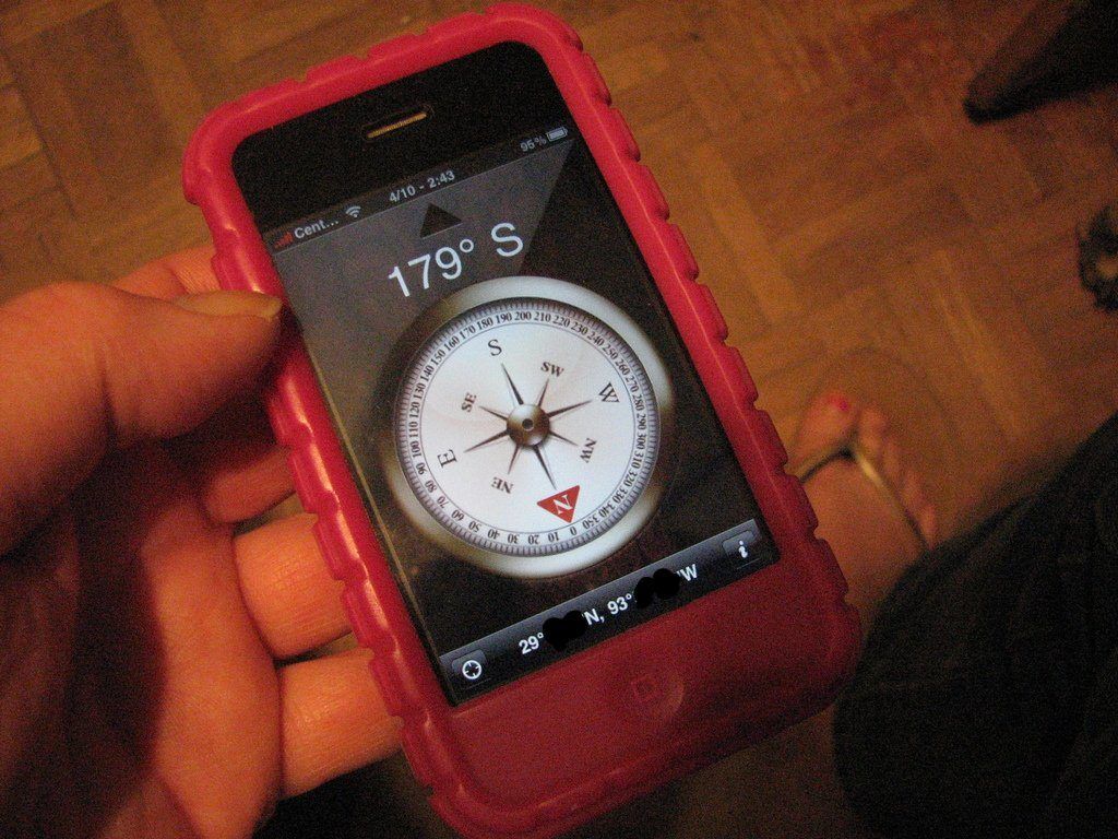

I guess the very first thing I need to figure out is where to aim it, on the compass.

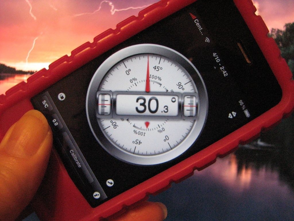

I have an iPhone 3GS with GPS and all those motion detectors, was shocked when I used the GPS on it and it showed me almost to the inch where I was standing on my deck, in real time as I moved around.
So I got a compass app and a level app that looks just like those incline levels you guys have shown in other threads.
I can place my iPhone alongside the flat metal parts of the dish mount and use it to aim it precisely at a specific compass direction.
And I'm sure I can do the same for the incline stuff and decline and all that. I hope. Right?

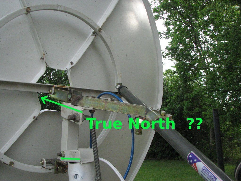

So, do I point the mount towards true north? See the picture below, is this what I need to do first?
EDIT: Ooooops!! I think I should have said true SOUTH.....
Then once that part is locked down in place, I guess I need to set the angles, right? I need to watch that video a few times and sit and meditate on it over a few cups of coffee.

So I guess right now I will worry about aiming the mount at some place on the compass.

I found out that I can't put my iPhone up to the metal, I guess it has a real compass in it. I thought it was electronic but the metal totally messed the compass up. I think what I will do is clamp a looooong stick to the mount to move the iPhone several feet away from the metal then hold the phone to the stick.
It appears I have to point the mount towards true south. Do that first. Then start tightening up loose bolts. Then set the tilt. There's two tilts to set. I don't understand them but I'll figure it out somehow from the videos. I frickin HATE math.. And I double hate geometry! :mad:

First, you are looking for TRUE south, not MAGNETIC south. Go back to dishpointer or where ever you found the original direction to aim your KU band dishes, true south is true south for KU as well as C Band. OR, if you have a clear sky tonight, go out and find the NORTH Star, place something on the ground pointing AT the North Star using the pole as the base to aim from, then the next day, point the dish in the opposite direction, THAT will be TRUE SOUTH, no other way to think about that one, and no compass needed.
Second, skew on your dish is NOT going to be a problem once you have it lined up for your true south. Just as with the KU dishes, as the dish moves, so will the skew, it'll be automatic, so there's one less thing to worry about.
