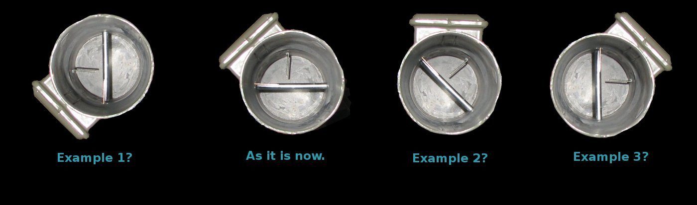

I found a photograph I took of the lnb back when I got it new last year.
I put it in the paint app and blacked out everything but the lnb and then rotated it to various ways it could potentially be set to.
Now imagine you were behind the dish, looking through the hole in the center of the dish towards the lnb out front. This is what you would see..
The second image is how it is currently set. You guys say it is set wrong because MeTV shows up as a vertical channel instead of a horizontal channel. Y'all say I need to rotate the lnb.
In your opinion, which would be the right way to rotate it?
I think I will put some marks on the lnb and ring before I change it from what I have now so that if all else fails I can get back to where it is now which is kinda working..
Thanks guys! :)

Rotate to either picture 1 or 3, your choice. Results are the same either way.
Looking at some of your earlier pictures (good that you put the big mark on the LNBF! ;) ) it appears to not agree with item #3 below.
But, it's a simple change, and you'll probably fine tune it for rotation and for focus (in/out) while you are at it, so it's not a problem! ;)
- 2. - move the dish to the top of the arc. As you sweep the dish (motor) from east to west, in the middle the dish will be pointed higher in the sky, than at either end. Set it there, lock it down, and leave it for this exercise!
- 3. - skew the LNBF to zero. Find out what LNBF you have, and how to twist it in its mount, to set it to zero at the top of the arc (also known as TS [true south]).
As a rule of thumb on the C & Ku LNBFs, you set their mark or their zero to "up" or 12 o'clock position.
The C-band LNBFs like the GeoSatPro C2 or WSI/Galaxy 242, their zero mark goes at 9 o'clock.
(double check, as this is from memory)
Set it, lock it, and forget it.
I agree, the skew you want would be either example 1 or example 3, either will change your "V" to "H".
Don't forget to redo the STB settings accordingly.
In your pics Dee-Ann, it looks to me like the small probe is off-angle a wee bit, compared to the
opposing bar it's pointing to. Maybe it's just the camera or flash angle?
Would anyone recommend trying to straighten it out if it is actually out of alignment?
I guess maybe; "if it ain't broke, don't fix it" might apply?
By the way Dee-Ann, you've made great progress in only a few short weeks, WAY TO GO!
Here's to "rocket surgery" --Cheers!

Then I spent a few hours messing with the lnb and rescanning over and over. So I got it where now the channels show up in the horizontal on a blind scan and no longer on the vertical. The picture is strong and stable and very clear. It looks GOOD....
