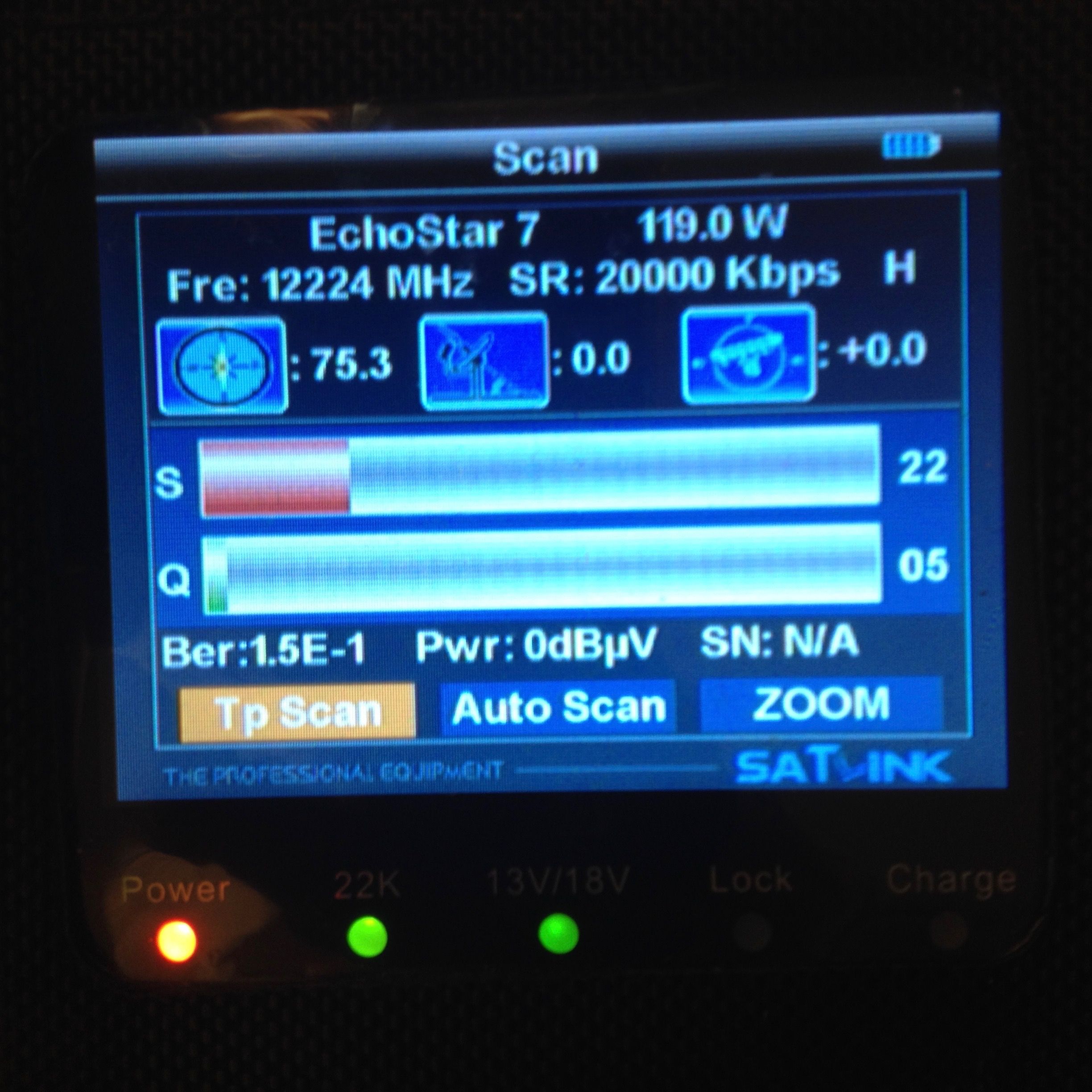

Because nobody answered above question I try to upload a picture in order to make it clear what I did. Hopefully someone could guide me or correct my settings.
I try to setup Dish Network 119W (Echostar 14, or DirecTV 7S, or Anik F3) I hope the Echostar 7 is same because it was in default Sat US database.
I have a Motor Home and I need to setup Dish Network every few weeks. I have a rooftop inMotion antenna, but sometimes the trees or other obstacle prevent me to using it. So I try to setup my single LNB (Winegard MP1).
Please help me. What you see in the picture is correct for this?
Any help would be highly appreciated.

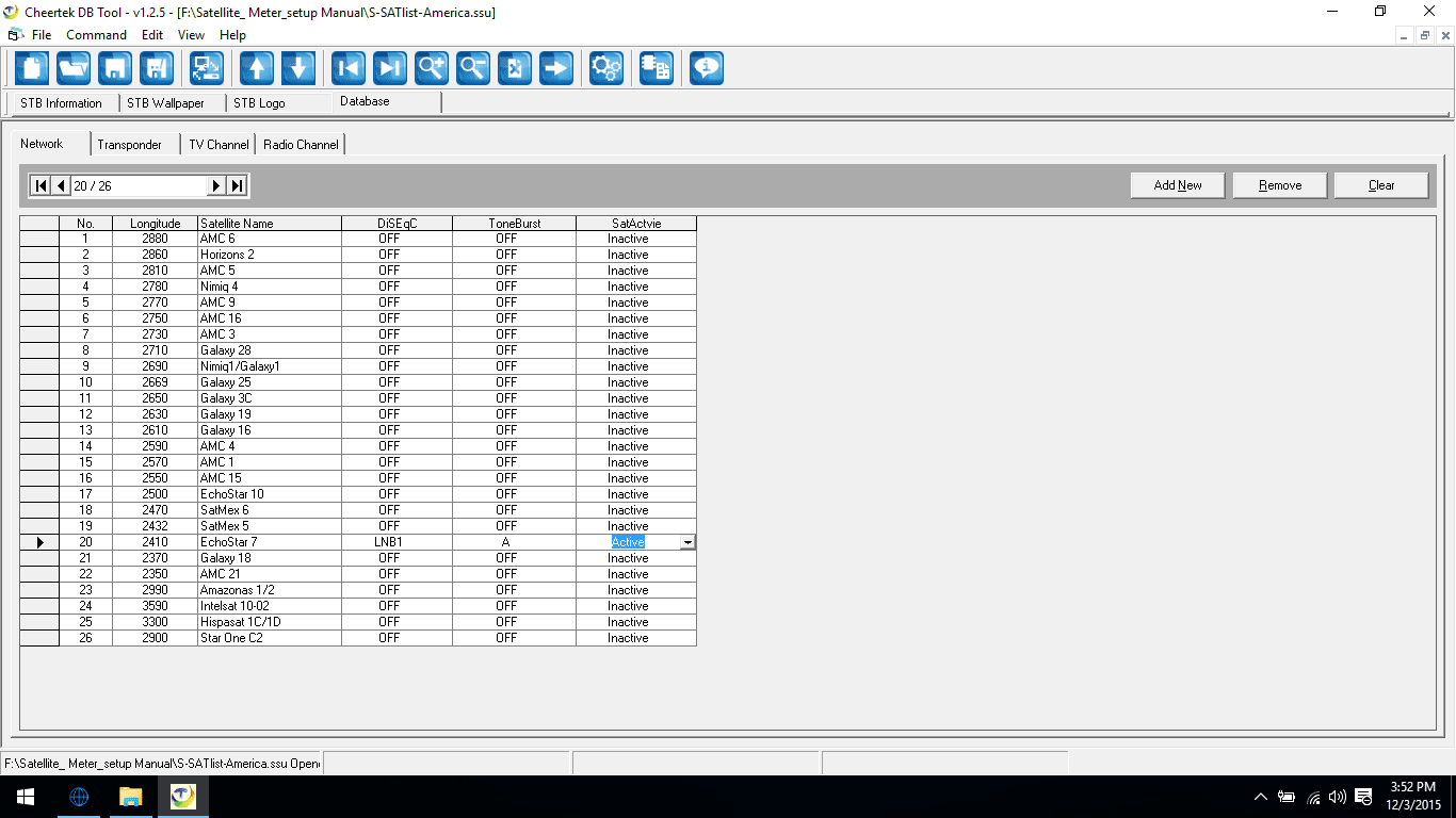

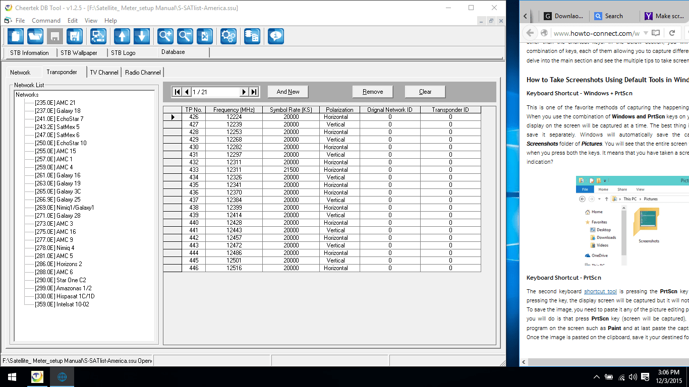

Thank you very much. Now I see this Lyngsat.com website, but I can not get any closer to my problem. Here is the two screenshot of the preloaded Sat list of WS 6908
As you can see NO Echostar 14, or DirecTV 7S or Anik F3. EchoStar 7 was choosen by me because I thought 241E = 119W correct? On the second screenshot I edited Echostar 7 to LNB1 and changed to active.
Anything else should be corrected on this Satlist?
Thanks
If you can find Echostar VII, you've found Echostar XIV by extension. Similarly, if you can't locate Echostar VII, you won't alternatively be able to find Echostar XIV. The LNB and dish design are such that you can't point at one without pointing at all of the others within a degree or so.
