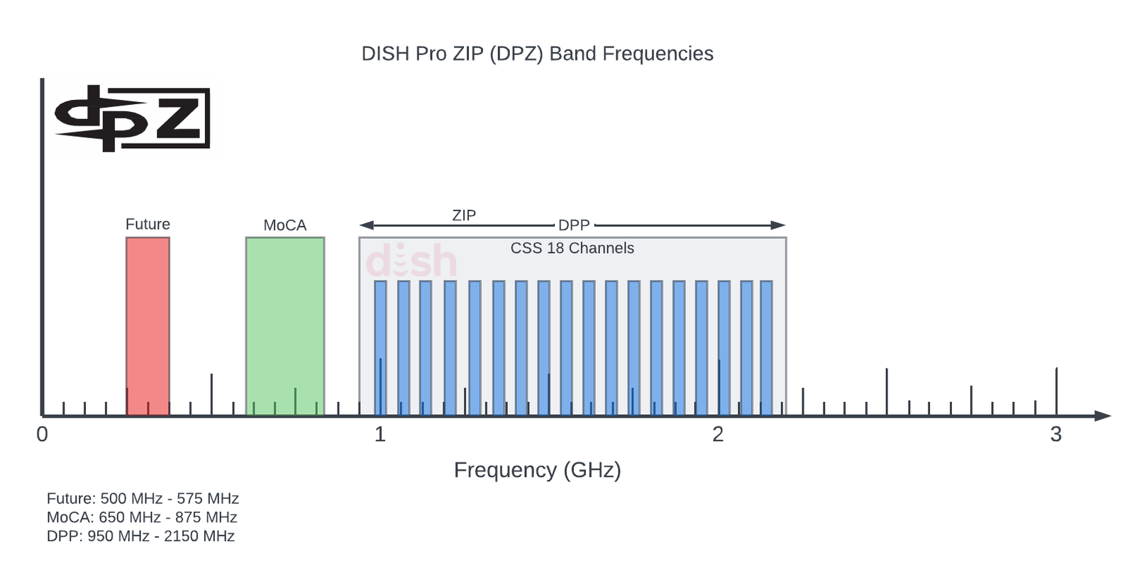

This is what I found. The Frequency ranges are confusing to me since I thought ALL Hoppers use up 3000 Mhz
DPZ is older legacy equipment
  • DPZ Frequency Range:
    • 500MHz - 2150MHz
    • Minimum 3GHz rated RG6 and components required from LNBF to Receiver
    • Note: Tight bends in cable reduces the frequency rating
  • Communication:
    • FSK
      • Includes all the advances from DiSEqC
      • A new protocol was needed for the channel stacking technology
        • Each CSS Channel is set to the desired satellite transponder
      • Support 16 tuners simultaneously over one cable for the Hopper 3
      • Only ZiP equipment is compatible with FSK
        • Dish Pro Hybrid LNBs are backwards compatible with DP/DPP/XiP receivers using DiSEqC
    • Channel Stack Switching
      • Full Transponders are split out (rather than odd and evens)
    • MoCA
      • MoCA stands for Multimedia over Coaxial Alliance and is the standard protocol for transmitting Internet data over coaxial wiring, or Ethernet over coax
      • Clients (Joeys) in DISH systems use data transmission instead of video signals to function
  • Tuners Supported Per Coax:
    • 18, 16 for receiver use
  • Diplexer Support:
    • None
    • Note: OTA and TV2 feeds cannot be diplexed on DPX systems as they run on the same frequencies as MoCA and will interfere with each other
  • Splitter Support:
    • Spitter use is designed to split Client feeds (MoCA)
    • Client feeds require at minimum 900MHz rated RG59
  • Channel Stack Splitter Support:
    • In commercial installations Channel Stack Splitter use is designed to split the CSS band for multiple receiver use
    • Up to 8 Wallys in dual tuner mode
    • Up to 16 Wallys in single tuner mode
    • Channel Stack feeds require at minimum 3GHz rated RG6
    • Note: a power inserter or switch is required
  • Check Switch:
    • 1-5 steps depending on equipment attached
    • 500MHz - 2150MHz
  • Communication:
    • FSK
    • MoCA
  • Diplexer Support:
    • None
  • Splitter Support:
  • Check Switch:
Fantastic information. Thanks a lot.
However, I think you got your DPZ/DPX group labels backwards. DPZ appears to be for Hopper3s (owning to the 16 (18) simultaneous channels), DPX appears to be for the earlier Hopper1s, Wallys (single tuner), and Hopper2s (three tuners). Is that correct?
Also, from what I understand, DiSEqC is the communication protocol that is used in the MoCA band to do all the switch configuration inquiries and receiver identification. And DiSEqC commands are used to select which channels are in the group of 16 in DPZ, correct?
Where do ViP receivers fit in these schemes?
Lastly, just to clarify, in DPZ there is only one group of 16 stacked channels, correct?
Reactions: charlesrshell
FSK stands for Frequency Shift Keying. This is where the carrier frequency is shifted slightly up or down to indicate a "bit" of information. This scheme is more immune radio propagation and fading issues than CW (Continuous Wave) transmissions where the carrier is turned on and off to denote "bit" information.
FSK was first used in wireless telegraph systems to denote the "dits" and "dahs" for Morse Code. FSK is now used routinely in wireless digital systems to indicate digital 1 and 0 "bits" of information. Some systems use multiple shift levels to "compress" information (say 8 shift levels for values 0 to 7) into the same bandwidth.
A similar scheme, PSK, changes the phase of carrier instead of the frequency, and can use multiple phase shift levels for similar compression.
So this is at the sat transmission level? Which rx's use it? Everything hopper-forward?
Dpz was dpp with a solo node or duo node.
Dpx is hybrid
Now I'm even more confused. The info says that DPH, which we've previously established to mean DishPro Hybrid, is backward-compatible with all rx's that can use DP & DiSEqC- how far back in rx's would that go? Thus "Dpx is hybrid" would seem to contradict that statement by DiSH. My understanding from that information is that all the new stuff needs something more advanced than simply the old DP stuff, but that they're now putting out LNBFs and the like (Hybrid) that can be used on both new-rx installs and older (possibly) pre-hopper rx's. So has there been a DPX-only LNBF?
What are solo and dual nodes and what rx's used with (not mentioned in the explainers)?
Finally, what is an XiP receiver? It looks like a ZiP receiver would be something at the hopper level but using the DP(Z) scheme rather than DPX. Is it like ViP, then ZiP and then Xip? Never heard of this.
FSK is only used in MoCA communications between devices on the local coax, and has nothing to do with the satellite signals.
I think I'm beginning to understand DPH now, it's all in the acronym of "hybrid". It appears a DPH LNBF is a configurable LNBF as four LNBFs in one, DP, DPP, DPX, and DPZ. Once the device configuration on the coax network is identified, the DPH LNBF is told (via MoCA commands) which LNBF to act like for each of it coax output ports. Then, with all of the appropriate nodes, diplexers, and switchs the correct LNBF style information is steered to the proper group of receivers.
Have I got this correct?
