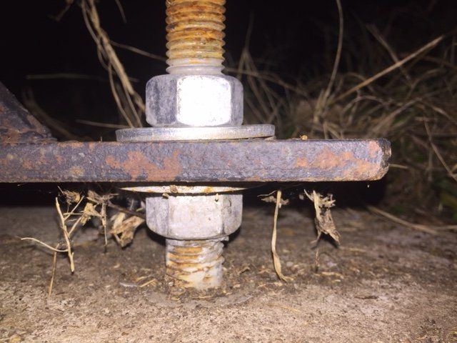

If you were to have a nut above and below the pole mounting bracket, then you'd have adjustments to fine tune for plumb. It looks like you have enough thread on the concrete embedded mounting bolts that you could simply add another nut.
On the polar mount, my thinking is to have all the bolts equally threaded into the welded nuts. Then turn each bolt in equal turns until the mount becomes snug onto the pole. Once polar mount bolts are all snug, check for plumb and make any adjustments needed on the pole mount nuts.
Better to have everything as close to 0.0° (or 90.0°) as possible now to eliminate any variables later.

Thank you Primestar31, i will perform the "string test" tomorrow or Friday.
Hope i'll pass the test, if not, a lot of work to do removing the bolts and nuts again :(
