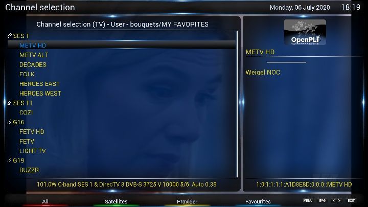

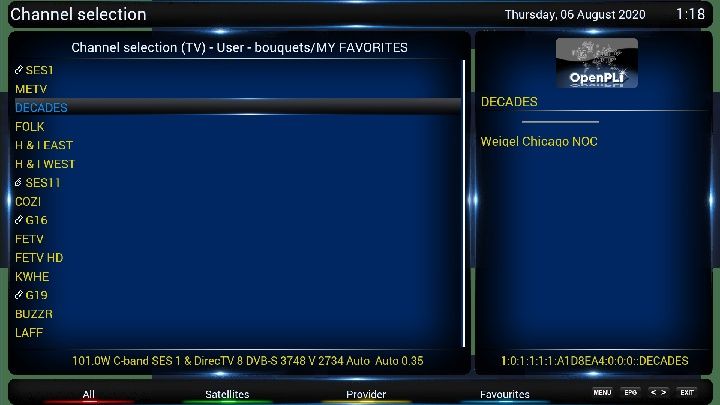

The reason I downloaded the clock extension was so I could have something showing on the front panel display. In TNAP 3.0 when I made my "Favorites" bouquet the satellite names were lined up against the left side of the screen and the channel names were slightly indented over. However in TNAP 3.2 the satellite names and channel names were both aligned to the left. You can see the difference from the pictures. I preferred the channel name to be indented over. So, I thought well, I'll just add some spaces to the left of the channel names and see if that works and it did, they looked fine. However when I did this there was nothing showing on the front panel display anymore (the channel names show on my front panel as I'm running My Blue Shadow for my skin), it looked like the receiver was turned off. Which is really no big deal, I was just used to seeing something up there. I remembered seeing the clock extension the other day and thought if I downloaded it I could go ahead and fix my Favorites bouquet the way I wanted it to look and have something on the display also.
Maybe some day they'll add a option in the My Blue Shadow skin to show channel names or the clock.

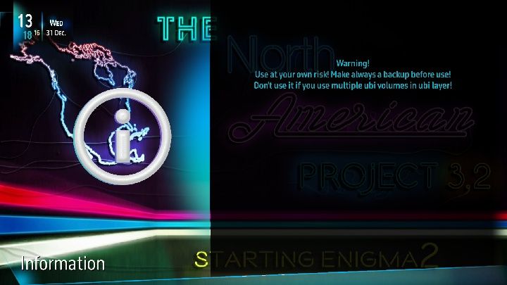

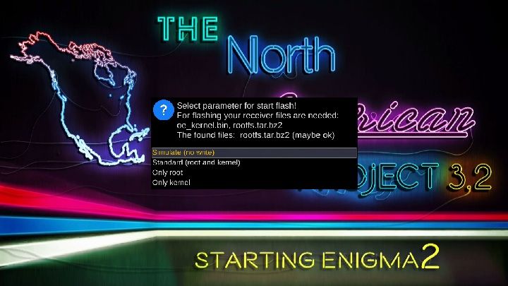

I made a backup of slot 2 and rebooted to slot 1 and then I brought up the backup plugin and clicked the blue button to restore. I then navigated down to "fullbackup_osmio4k" and clicked the green button. After that this screen came up:
Is this correct? If so, what button do I push next?

I pressed OK and the next screen gave me 4 options, which one should I choose?
