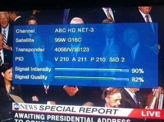

I don't think that the above statement is correct. When I record 2 different streams on the Manhattan, for the same amount of time, they come up with different file sizes depending on the amount of motion in the video and the type of programming on each of the streams. The Manhattan records just the stream being viewed or recorded. As Iceberg mentioned, it allows 2 streams on one transponder to be recorded while watching a 3rd. That's handy for the networks on 99W C-Band.
