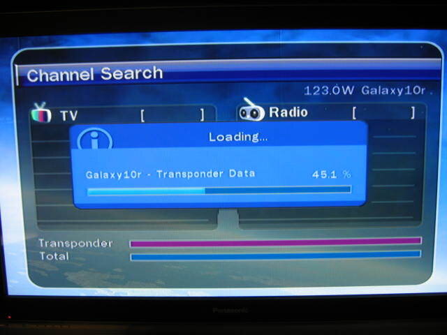

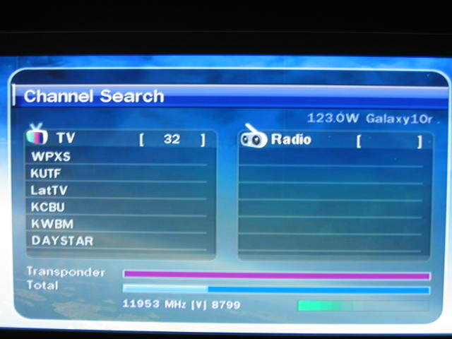

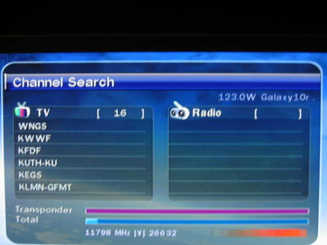

For all of you that are waiting,here's some pics I snapped yesterday, I have ID'd at least one other niggling issue...audio. Audio only channels are very flaky. Sometimes they won't come in at all. I am on 119, sometimes it will just sit there, no audio, then bam comes right in. :confused:
Well, lemme go aim that dish, here's the pics.

Blindscan works different, setup is different, everything is different. And its too new for me to say if it is better or not. That will take some time. :)

1) Hangs with 4:2:2 AND HD feeds. If you have a sat stored like Anik that only has 4:2:2 feeds better not try it, I had to reboot three times before getting it changed. They need to change this pronto.

3) Listen to Brother Ice, change the blind scan frequencies and the blind scan works MUCH faster.
