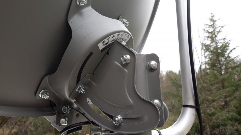

The Orby TV equipment was delivered to the installer in a single carton with protective foam material. The dish and mount are both very good quality hardware. The mount has skew and elevation setting scales. The mount could be improved by adding fine-tuning mechanism. The installer had some issue optimizing the elevation setting using only the lock nuts providing friction to make small movements. No different than the issues that we often deal with on FTA gear, but most subscription mounts have elevation fine-tuning resulting faster installs and happier installers. :biggrin
The dish mast is standard 2" heavy duty j-pole with a large foot plate. The package did not include masts support arms, but the installer observed that the combo dish and OTA antenna needed more support. He installed a spare mast support arm from an extra DirecTV package in his truck. I would suggest that the support arm(s) be included as standard equipment with all kits. This would likely reduce future tech rolls for dish realignment.
