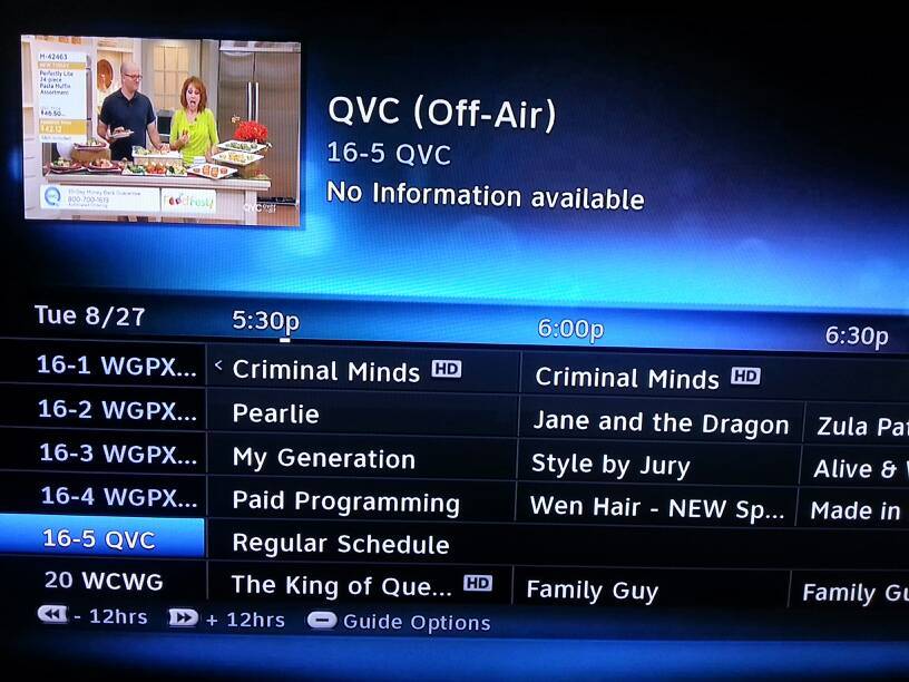

Has anyone else noticed that the QVC channel that was recently added OTA on XX-5 on ION stations is now on the AM21? This would be intriguing because that would mean SOMEONE has been playing with the AM21 database. Is it possible that the recent QVCHD and QVC+ additions had anything to do with this?
I noticed it there after doing a RBR on my Genie. I will attach a screenshot.

The AM21 will take more than 2 zip codes. First set it up with your real zip code and secondary zip code. Then, do the initial set up again using your primary zip code and the zip code in a DMA that has subchannels you're missing. I live in NC and first did my zip (Greensboro DMA) and then a Raleigh DMA zip. I then did my zip + Los Angeles. Then, my zip+Vermont. That filled in my missing subs.
Someone on this site posted about this a while ago. I didn't believe it would work, but it did. Just spreading the word. The guide will obviously be wrong but at least you can watch/DVR all the channels. The QVC appearance is weird because the database doesn't have a QVC on any -5. And if it did, it would have the call letters, I assume. The AM21 will never make sense.

Yes, There is a workaround for the subscribers losing channels with the OTA scanning being removed from the Genies. It is very confusing and time consuming but most sub-channels lost can probably be picked-up by trying this method. It amazes me D* doesn't overhaul their system of delivering sub-channels OTA or train their CSR's how to intertact with the customer so they can receive all the subs possible in their area. With all the "cord cutting" going on I would think it would be in D* best interest to offer as many OTA subs as possible. D* seems to ignore OTA and tries to persuade the customer otherwise. In my area I pick up an additional 6 channels not in D* database by re-scanning more zip codes. Some of those are the most desirable OTA channels in my area. I hope D* changes some of their policies to help the customer receive all the OTA's possible in their area.
It should be noted that the additional zip codes method does not work with other software, just the xx7xx version (I know that's probably not the proper format, but you know what I mean - the new software with the 7 in it).
