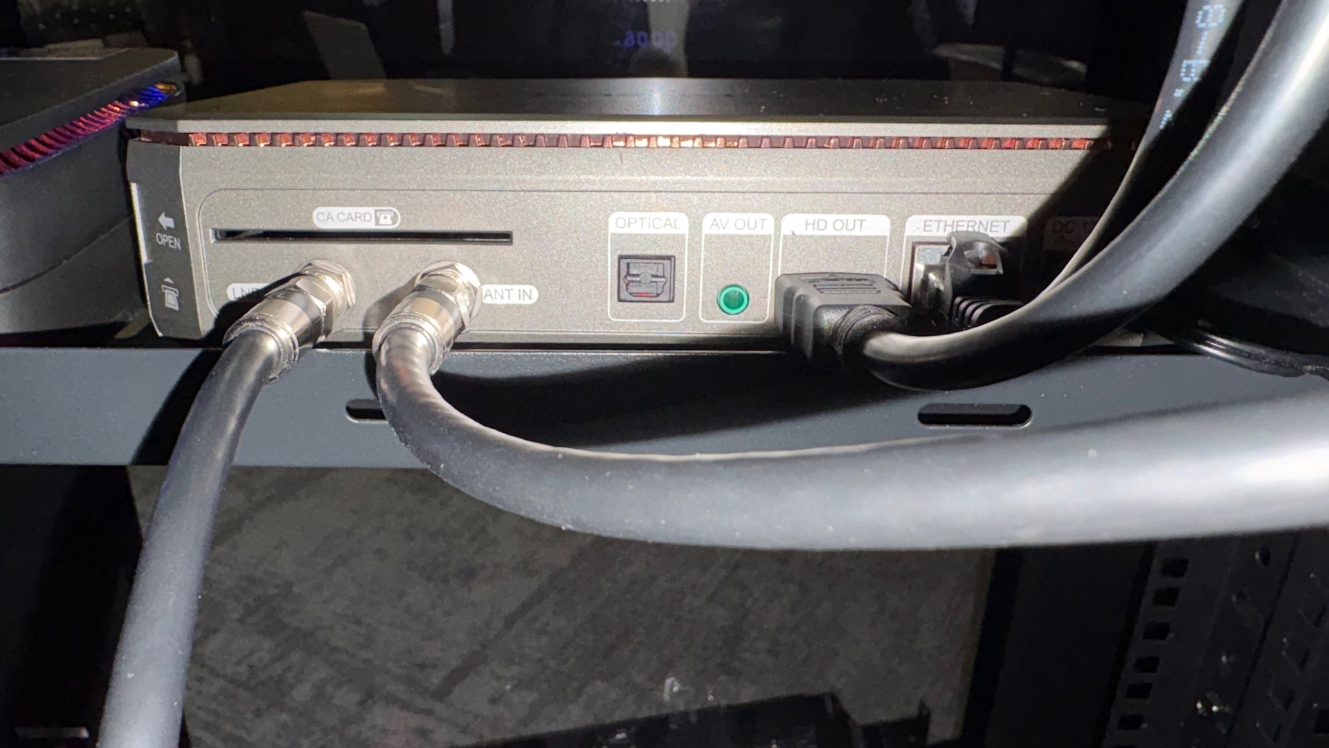

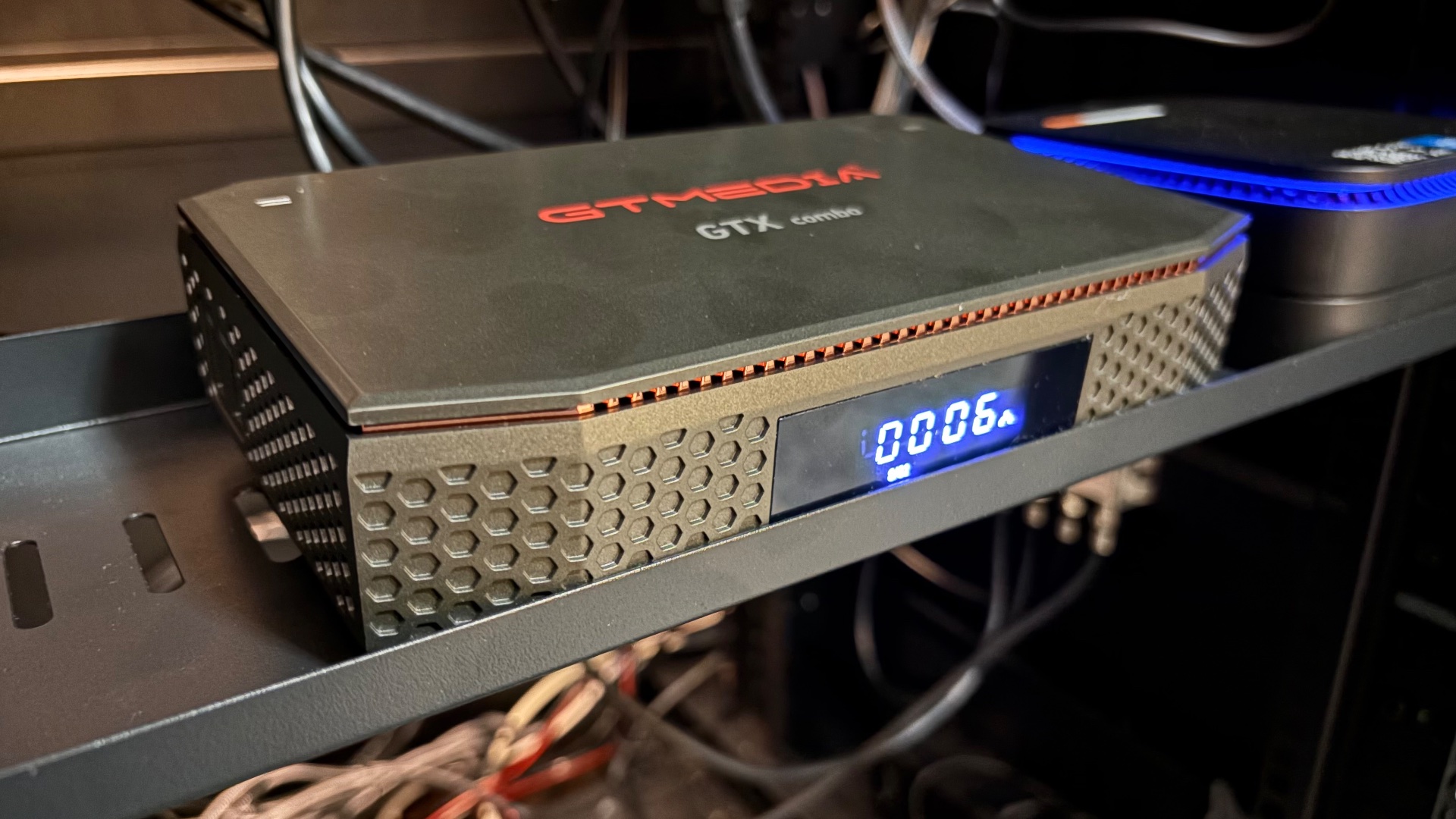

Picked up a GTMedia GTX Combo receiver from Ebay for $135 + tax. The unit is built on the Android platform and features a satellite tuner and a separate OTA tuner.
