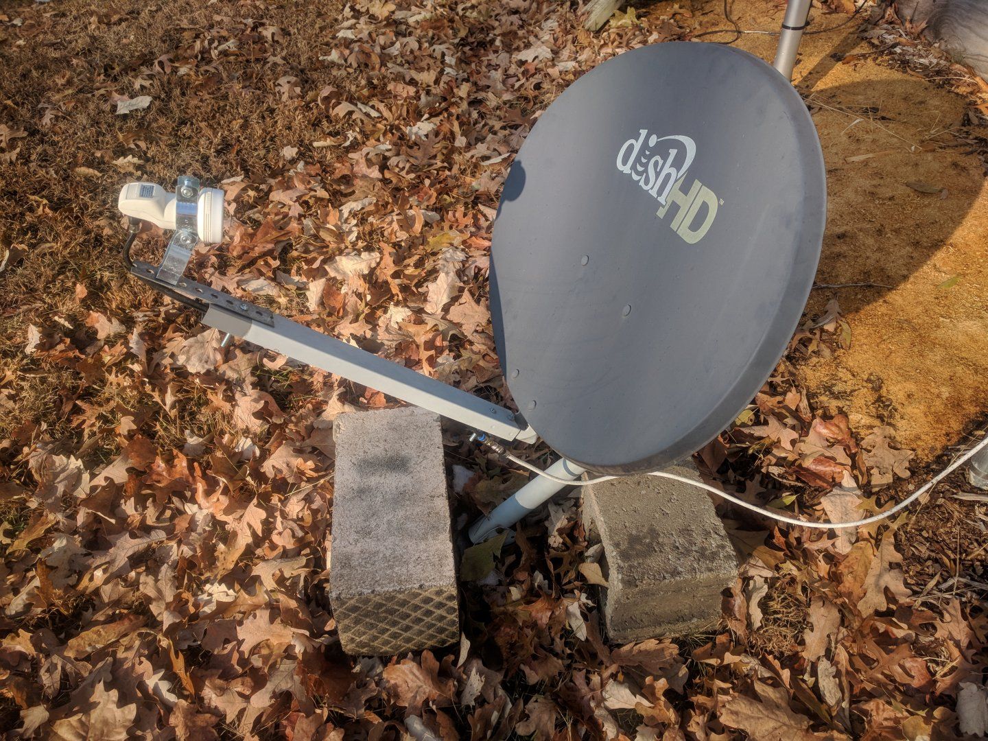

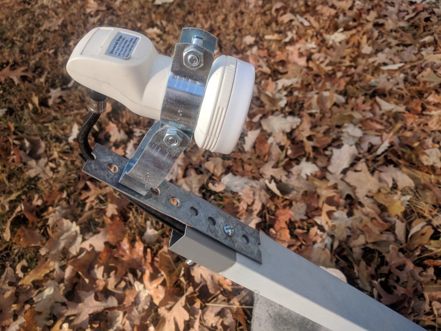

Here's one I'm using currently, probably similar to what you picked up. I also got it free from a neighbor that knows I'm into "crazy satellite stuff." Note the extension I had to fabricate to move the lnb away, it's just a piece of flat bar scrap bolted to the stock arm.
mine still has a plastic fitting at the end of the arm. It has a slightly wider mouth than the metal arm its attached to. Do you know if this should suffice?
Nice work. Plumbers tape and muffler brackets. Looks professional. I think i made mine out of a piece of wood and plumbers tape.
