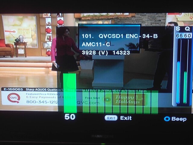

Just went out (since its 40 out..woo hoo) and did some tests. QVC shows on the GeosatPro at 70 quality. Clone Pansat 2500 (same meter like the 9200) flickers between 58-64. I know 30 is threshold on the 2500 so a 4 footer is probably possible
5FT C Band (AC3)
I used a 5ft solid metal dish set at 0.38 for my test. Geosatpro 1100c shows 50% Quality on AMC-11. Course it's audio is AC3 and I can't hear a thing unless I push it through a stereo. (One other thing.... you realize of course you are 'enabling' your Mom, by giving her that channel? ;>)

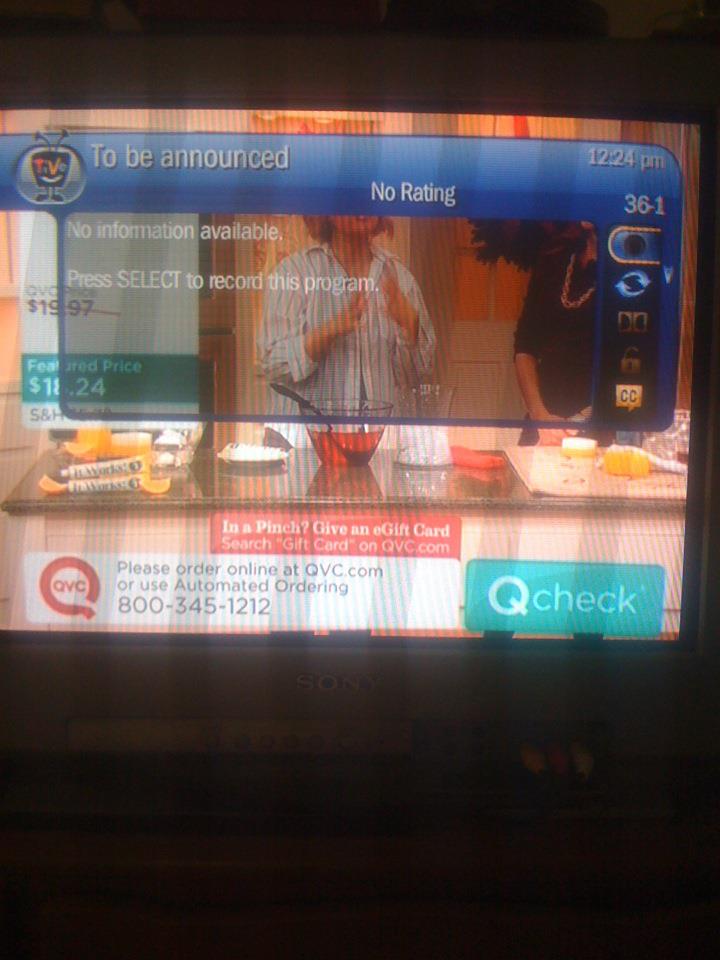

If you use an offset dish you need a conical scalar ring for your C band feed. A 4 foot should work, but a 6 footer would work much better. I only got QVC on my 8 footer, and I know the bit error rate was very low, and the signal is easy to lock. I can receive it now very easily, actually. This is QVC running through my QPSK to QAM modulator, modulated on channel 36:
