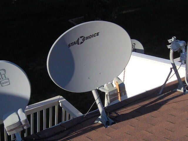

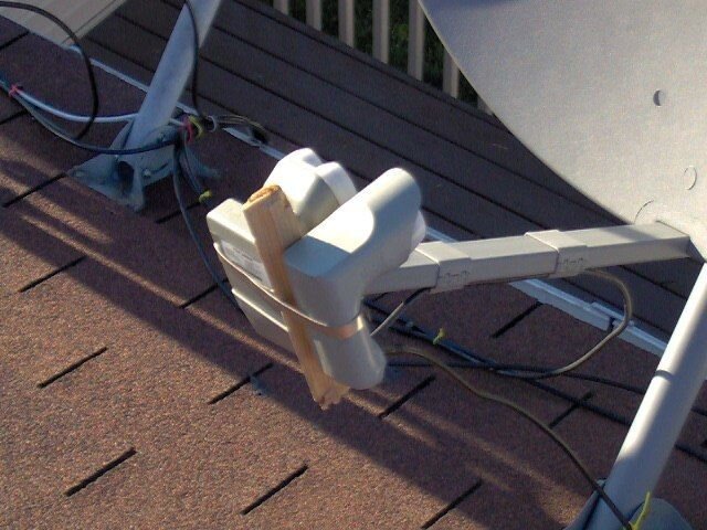

Here is my SC dish (with the DBS LNB at 119)
old picture but it gets the jist of the dish
