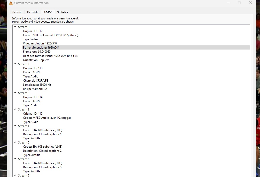

have you looked at the stream specs vs. recorded .ts specs in VLC? Just wondering how you're comparing bit rates, not questioning your eyes on graniness.
You can view stream specs from VLC. I would guess the same is true if you are playing back a recorded .ts from VLC
