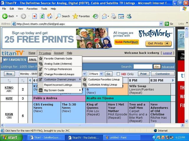

What I did was use where I use to live (Duluth) and say "antenna only" (Duluth only has 5 TV stations so it was easy...I still had Dish through them) and just click on add stations. Add the callsign and a channel number. Some people use what channel it is in their receiver. I use the legit channel and found what channel it is via here
http://www.global-cm.net/MPEGlistKuBandUS.html
see attached screenshots

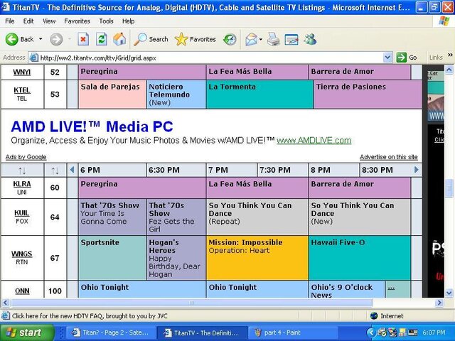

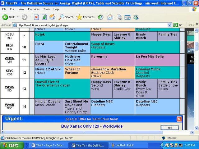

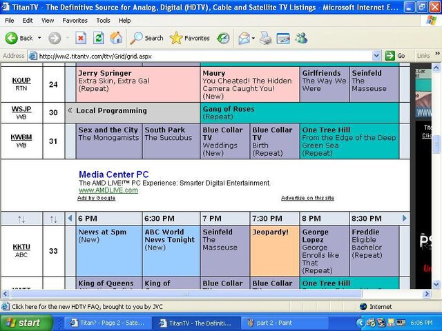

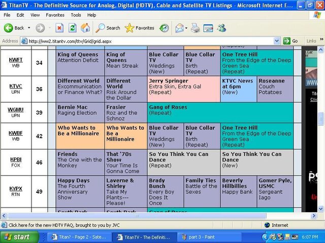

see attached...here are mine and how its set up. Some channels you wont need to add
KEYC is one of my "locals"
WVGN, WVXF, WPRU & WJSP are the C-Band nets I can get
ONN is Ohio News Network :)
KPBI is scrambled but I havent removed it yet

Just entering wpxs and the others
I get an error that say
No Matching Stations were found. Please try another callsign
under tv listings->customize channel lineups->customize digital lineup
DOH... got it working - had to add satelite, cable and ota options...
yep.
Thanks. You just have to make sure that you have the satellite (and maybe others? - I picked them all) options on. I didn't have enough options checked. I just turned them all on, hid them all, and then started manually entering locals and fta channels... Piece of cake once you can actually open up your selections to get the right stuff to select from.
