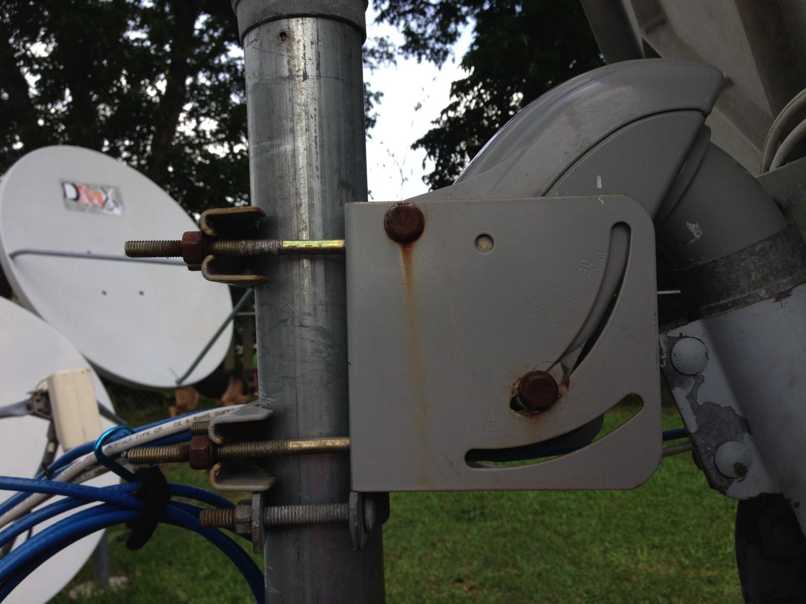

The motor bracket is warping when I tighten it in place! A LOT!
You can see that the bracket is twisted, a lot..
When I loosen the dish to adjust the azimuth it "droops" which is to be expected. But when I tighten it back up, it comes back up again but as I tighten the four bolts the whole dish will move all over the place!
It can move pretty radically in any direction and when it's pointed at 125 and I tighten just one bolt it can appear to twist or rotate a bit.
My dad came over and looked at it and he agreed that the bracket is flimsy and gives too much, that it's design is just rubbish.

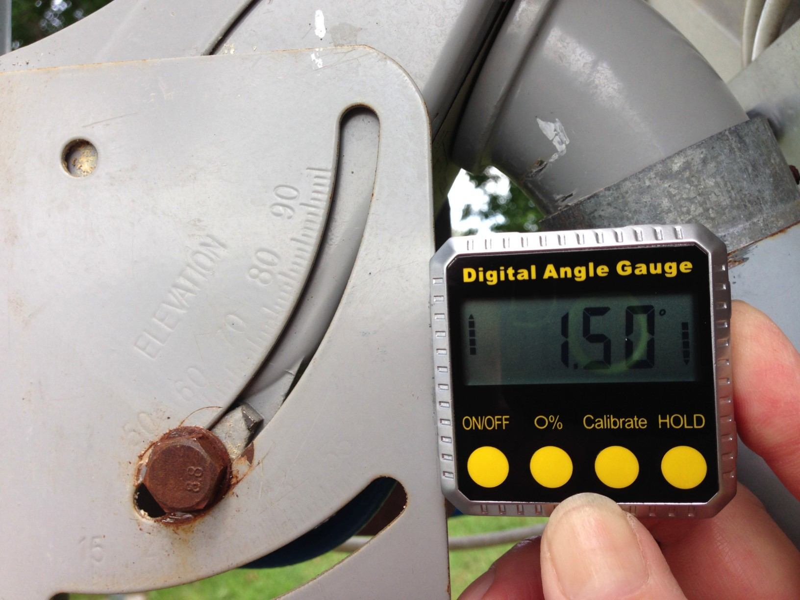

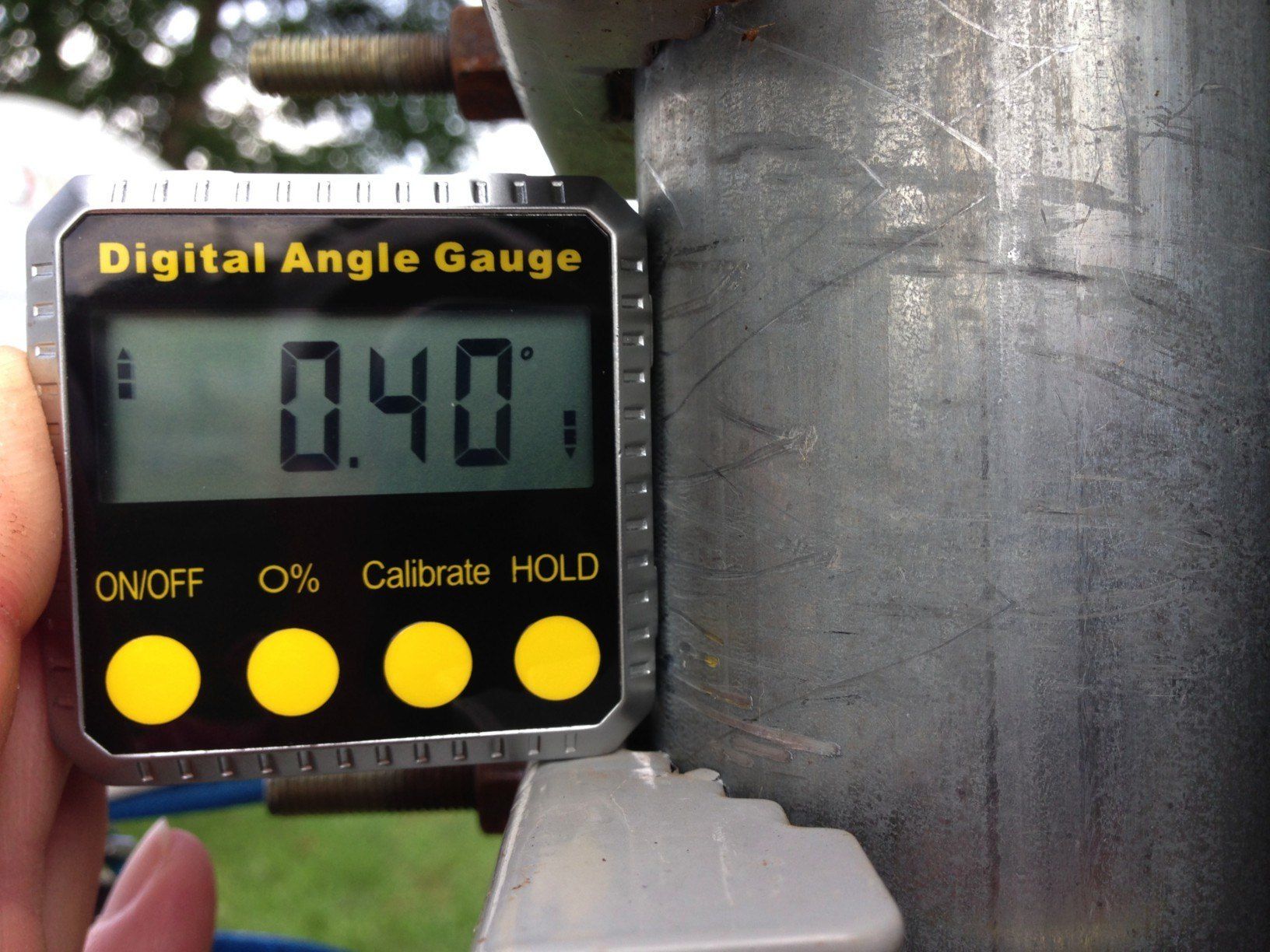

I put a couple of different angle meters on the pole and the bracket to demonstrate how much the bracket is out of whack from the pole.
The pole is 0.4 from being in perfect plumb. Looking at a level with a bubble in it and looking at the other angle meter with the little needle that moves by gravity, the pole appears to be perfectly plumb.
It's only with the digital meter that I was able to see that it's not.

Another day in the sun. And VICTORY!
This dish install holds the world record for the longest, slowest, most troublesome dish install EVER !!
Only the wars in the middle east took longer than the battle I fought trying to make this Frankendish work right !!
TIP: DO NOT MAKE YOUR OWN DISH FROM SCRATCH!! Just buy a proper one already made !!
I double checked again with the square and I found that the dish was still not square with the motor. So I fixed that.
The after I moved the dish to ZERO I found that the entire dish was skewed.
My dad looked at it yesterday and suggested to put some metal bars in between the clamps and the brackets to give it more strength and make it harder for it to warp when I tighten it up.
I had already put an old gate hinge on the pole for the motor bracket to ride on so it won't slide down when I loosen it. That alone made my life infinitely easier.
I took an old metal bar out of an old chain link fence and cut off two chunks and put them between the brackets and the clamps.
I moved the dish to 95 and got a signal, tweaked it a little then moved it to 125 and tweaked it there with the meter set on a PBS transponder.
I tuned the meter to the transponder with Montana PBS and there was nothing.
So I began to tighten the motor bolts evenly until the motor was unable to turn on the pole and as I did so, the transponder with Montana began to come in.
A little tweaking and I was getting ~everything~...
But the big question was would I now be able to get 72? So I moved the dish to 72 and there it was.
I found LPBS on 87. The Chinese stuff on 95.
103 has some interesting stuff too. But, the other day I had 103 pulling in COZI, however today I can't find it. ???
123 comes in but has nothing of interest to me, I can't find FSTV on it but I don't care because it's included with my Dish subscription. Meh..
And then 125... ALL the PBS stuff is coming in there! Some of it a bit weak so I may play with editing the frequencies or the symbol rates rather than mess with the physical dish.
I also suppose I could try to make very minute changes to the LNBF skew but that's a last resort. It's working so well that I'm afraid to touch it now!
