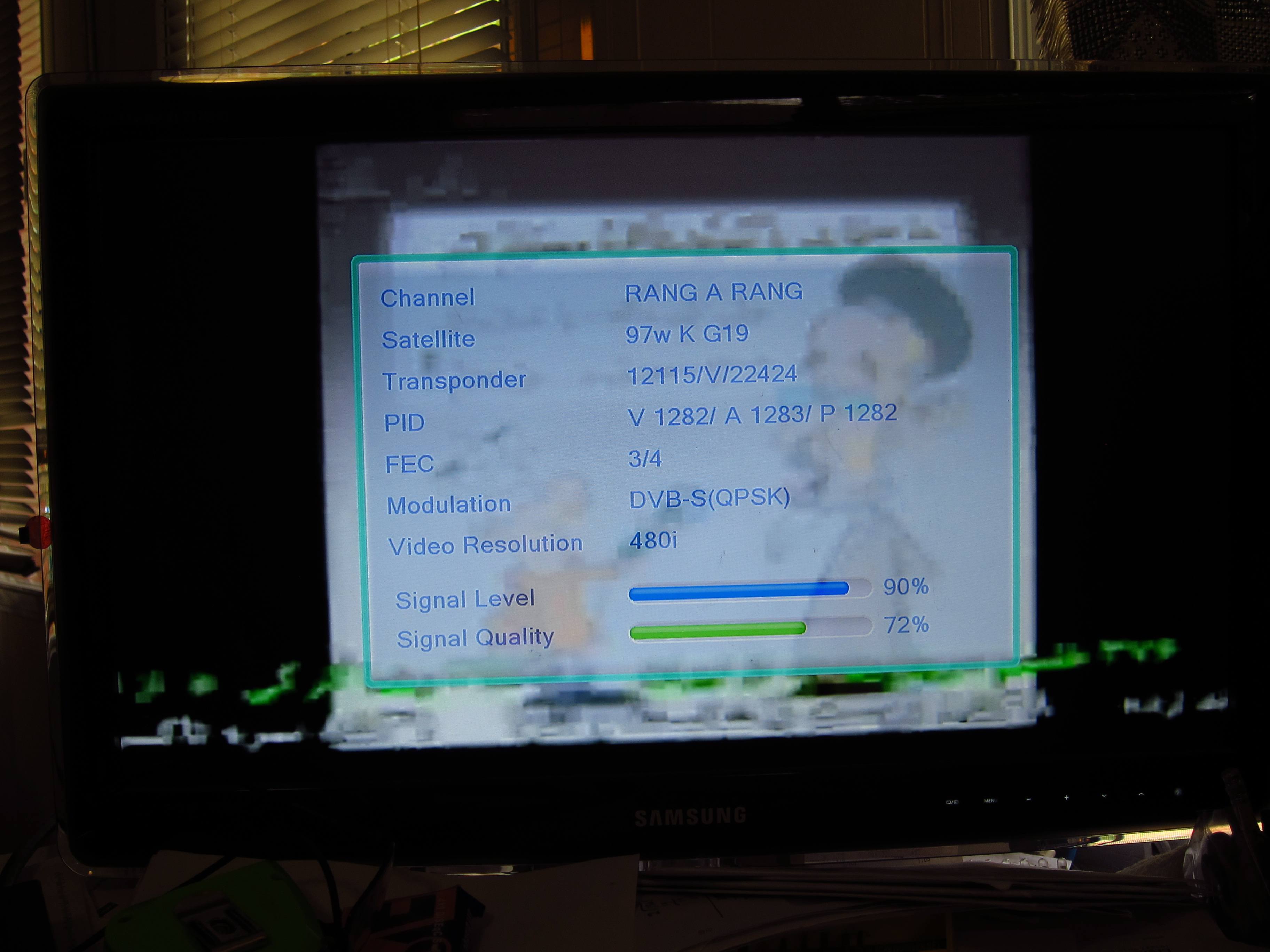

GREEN BAR MOVED HAPPY DANCE !!!!
Still screwed up settings as I was just wanting to get the damn Q-bar to move . Got it long enough to scan channels though I doubt it is the right bird .
Just happened while thumbing through TPs and sats . I very much doubt they are correct but with a 95 signal and a 95 quality I know I hit the azimuth .
Channel master locked onto a bunch but says 97W bird and 11789 Mhz Horizontal , channel 00056 Al Magribia as first channel which comes up as 97W .
switch TP and got nothing , but atleast I know the green Q bar works ;) Odd that it should be vertical though ? Now trying to get it back without disrupting elevation

Actually achieved my first goal . Q-bar went 95-99 as well as S-bar . Locked onto some channels on G19 accidentally when I was thumbing through TPs .

Best advice was elevation on dish is not based on standardized off-set . Got 95Q and 95S , found 240 channels . Turned off receiver to do some work . Came back , turned it on , motor moved dish off into the trees .
If you're using USALS to run the motor, did you tell it to go to 97W before you aimed the dish by moving things around on the pole? If you didn't, everything will be wrong when it does move.

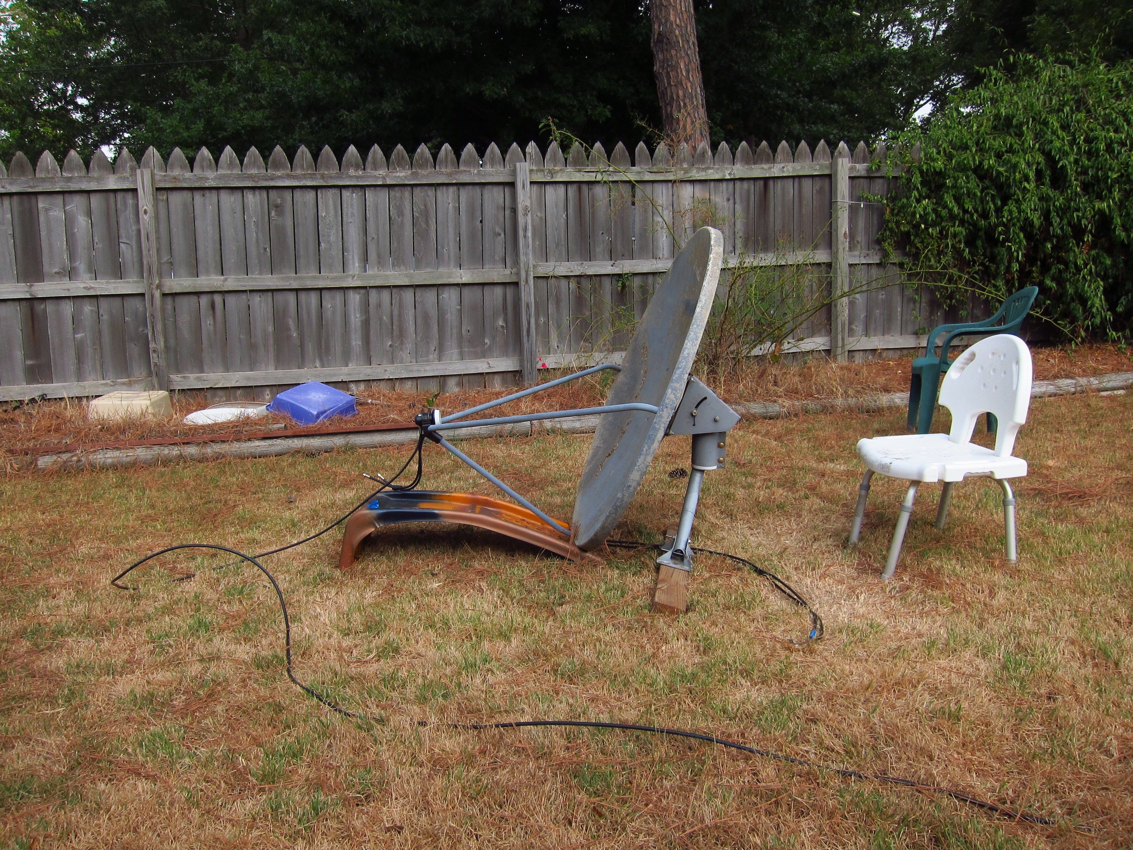

If the OP simply rotated the motor on the pole to 97W, then it seems to me that he's done no better than this:
IMG_1273.JPGIMG_1280.JPG"Woo Hoo Q!"
That playing-around setup became the following a couple of months later and serves me faithfully on 87W:
