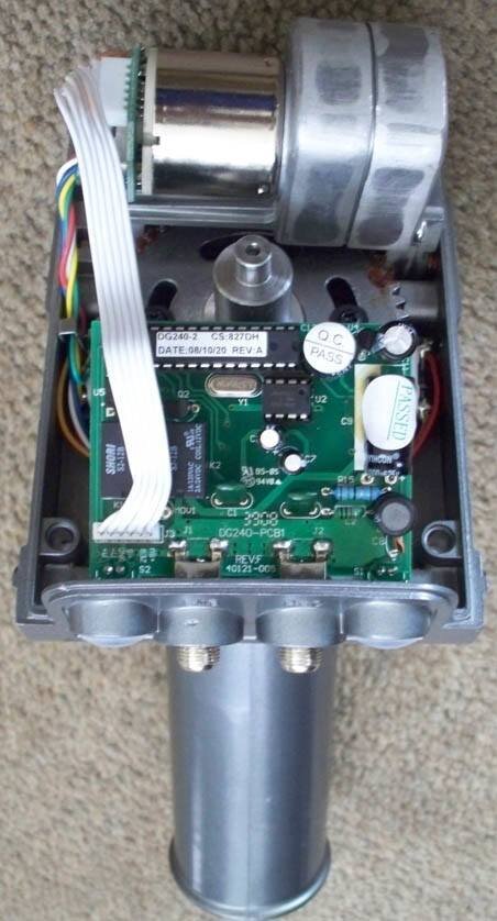

The best place to make this mod seemed to be in the DG-380 itself. It already has two connectors, so no external changes would be required. This voids the motor warranty, but I could care less. The mod can probably be done in a similar fashion to other motors. The steps are:
1. Loosen and remove the three screws on the bottom of the motor that hold on the top cover.
2. Remove the top cover.
3. Loosen and remove both F-connector hex nuts that mount the circuit board to the case (see "DG-380 Opened" photo). A deep socket worked for me.
4. Disconnect the ribbon cable tying the circuit board to the motor.

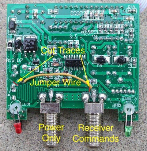

5. Cut the two traces indicated in the "DG-380 Circuit Mod" photo and add the jumper wire shown. You should check that the traces are broken with a meter, but be aware there is a nonconductive coating over the board, so you may have to puncture it or scrape some off to make a valid test.
6. That's it. Reassemble the case.
The photo shows which connector accepts the power for the circuit and the motor (right side when looking from the back when the motor is mounted on the mast) and which connector accepts DisEqC/USALS commands (left side). Note the circuit board photo is from underneath, so don't get crossed up.
